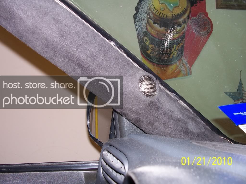

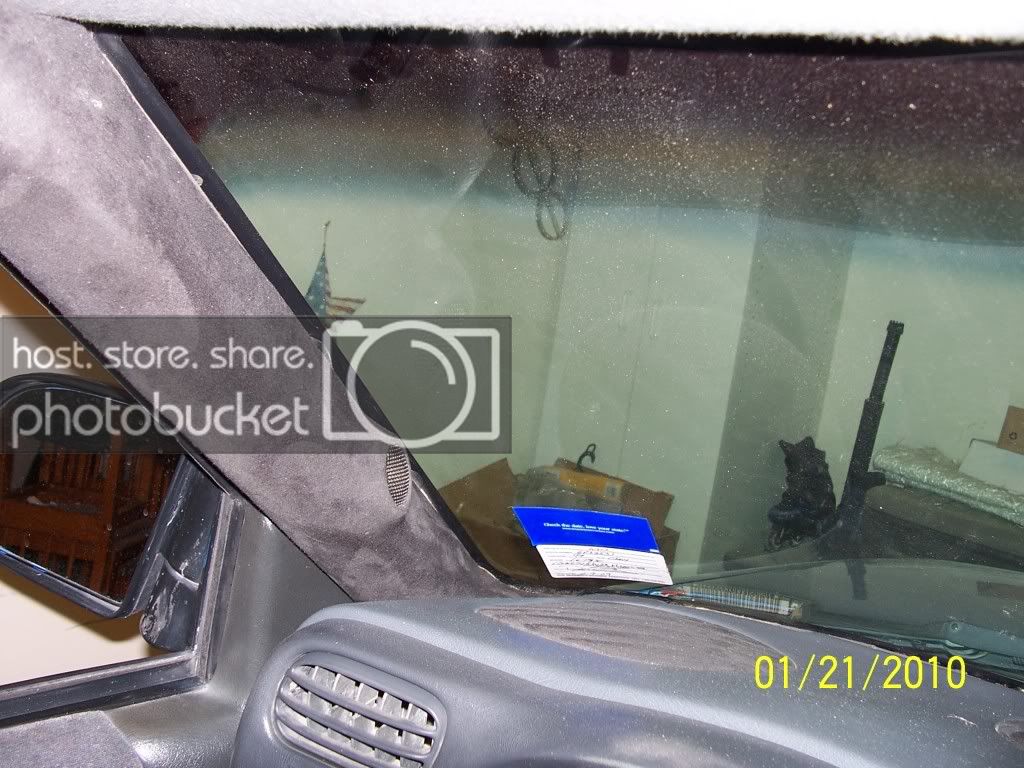

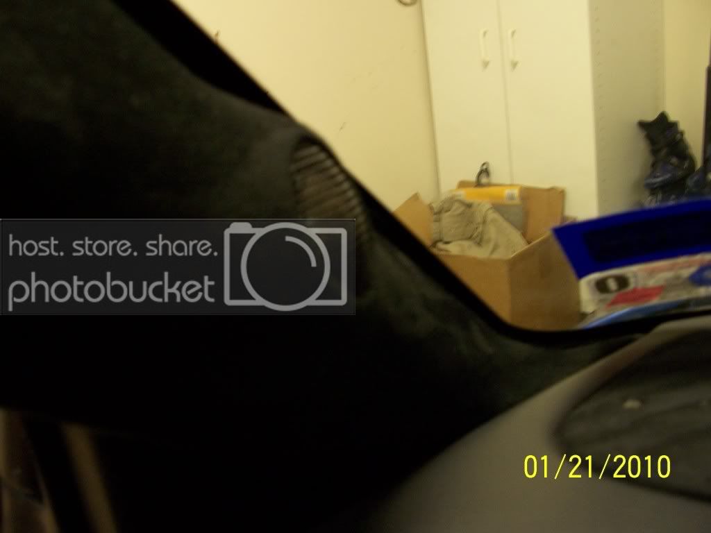

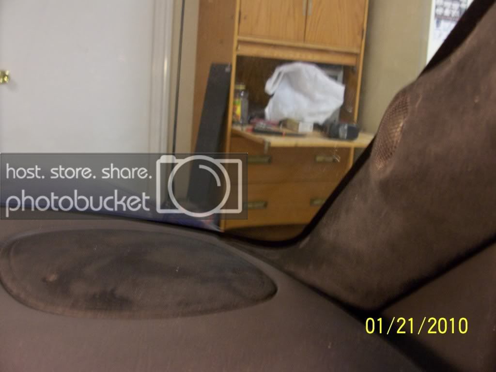

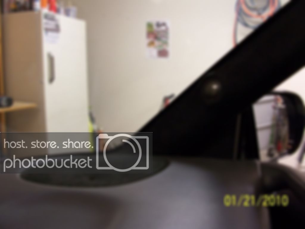

here are the new a-pillars i decided i needed to close up all the holes in the dash so i removed the pods from the stock locations in the dash and put the DD tweets in the a-pillars,then fiberglassed the stock speaker grilles and then covered them.also took out the defrost vent and glassed it and put a DD logo before covering it. everything was covered in black suede.
I basically took the flush mount kit from the tweets and epoxied the front trim ring to the a-pillar then molded up to it with some kitty hair and sanded the contour then cut out the hole and sanded the inside of the tweeter trim ring to allow for the tweeter and the suede then just mounted the tweet from behind with the factory cup.

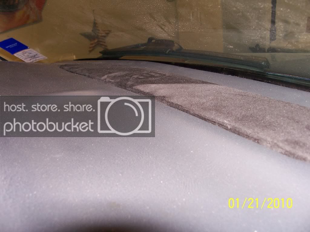

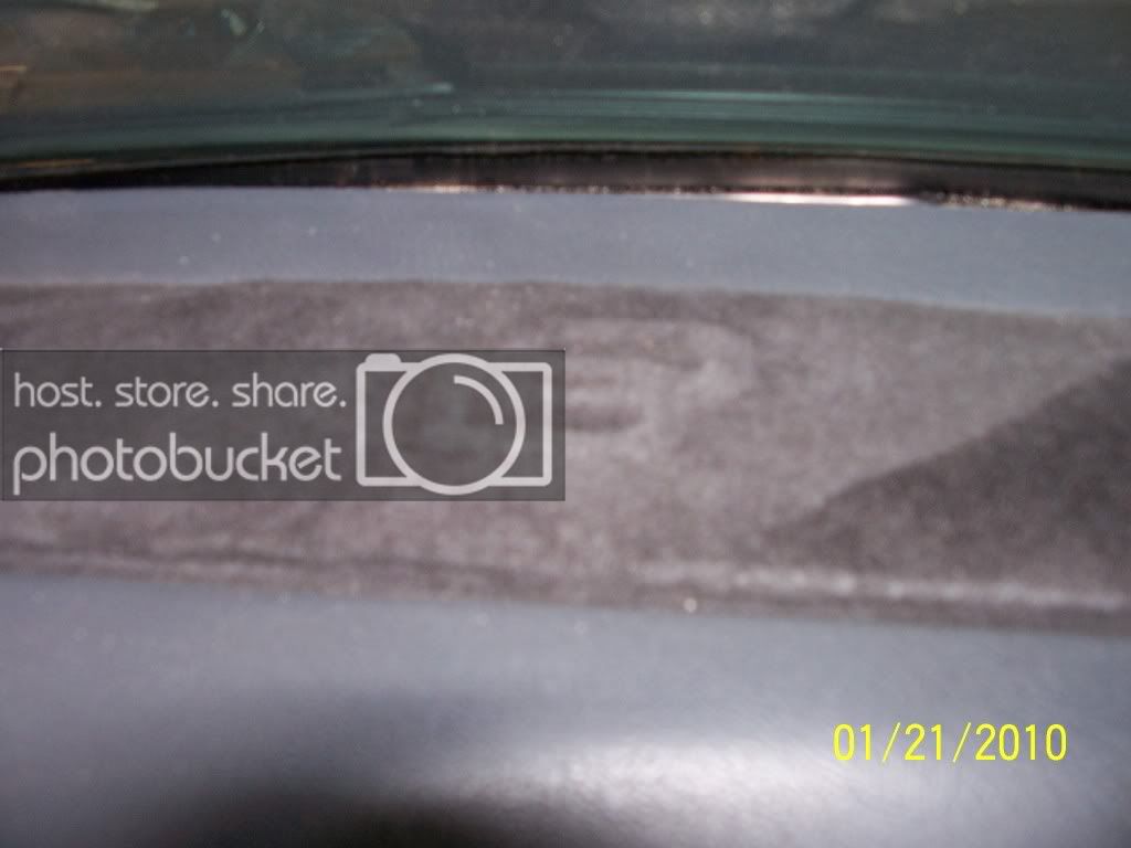

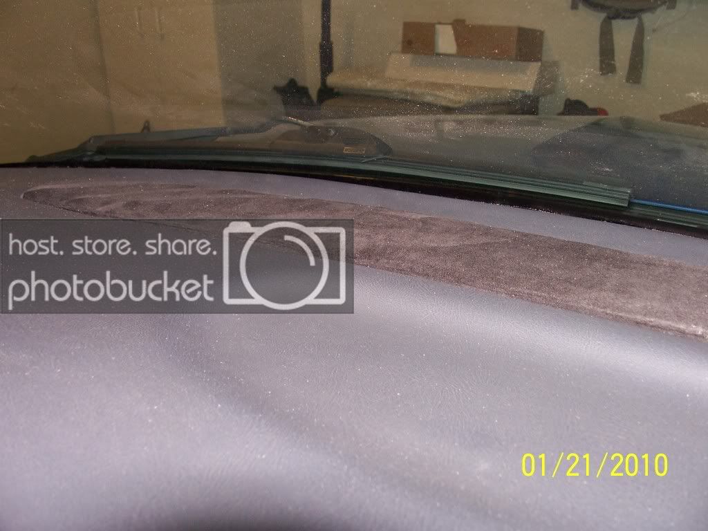

And the defrost vent
and the grilles
