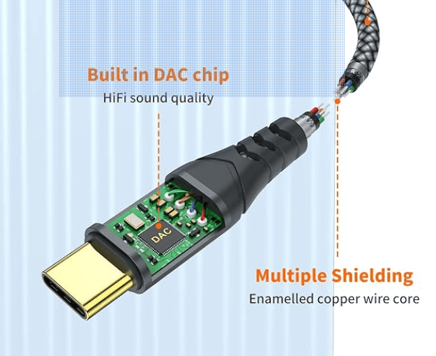

These days usb-c CAN output analog, but that is not the norm. Your usb-c to 3.5mm might have a builtin dac chip. Seems these days many do.
Is your adapter or phone doing the dac conversion?
Below is something I copied from another site...
"Now that 3.5mm headphone output is nearing extinction in smartphones, it's time to start compiling the list for the best USB-C to 3.5mm adapter DACs. Many phones don't even offer analog output anymore on their USB-C output , so the only option is to have a dongle/adapter with a built-in DAC."
Well I'll be damned! Never even considered that they could stick a DAC in something so small - low and behold, I stand corrected!
"This usb c to headphone adapter adopted an advance DAC Smart Chip, offer high-definition audio"
Amazon
Can't link the actual item but here it is - man I feel a little stupid right now!
JXMOX USB Type C to 3.5mm Female Headphone Jack Adapter,USB C to Aux Audio Dongle Cable Cord Compatible with iPhone 15 Plus/15 Pro Max, Samsung Galaxy S23 S22 S21 S20 Ultra, Pixel, iPad Pro, MacBook​
Don't I feel silly!
Cool, then I will get a decent outboard DAC so I can play my electric drums through my Crown - good to go!
Thanks for pointing that out!
Amazon
Don't I feel silly!

You're welcome. My main fogginess is when I learned that usb-c can now also output analog. I just wanted to be sure that it was not my phone dac doing the analog conversion. My guess is that when it's plugged into the usb-a going into the head unit that the phone somehow knows (some handshake) that usb-a can't pass analog so it must send digital to the HU Dac. Or can the phone detect the downtream dac? Maybe someone has a more accurate description of what's happening there.
Your phone dac may be better than the adapter dac. Might be good to get a dumb adapter to try, or like you say, get a dac adapter. Good luck. I'll be curious if you get better audio.
