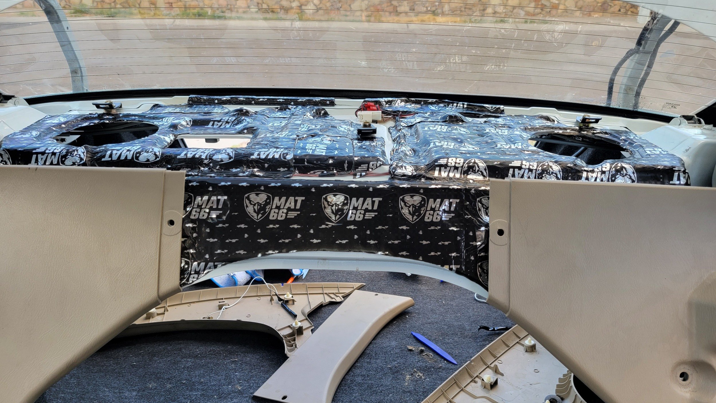

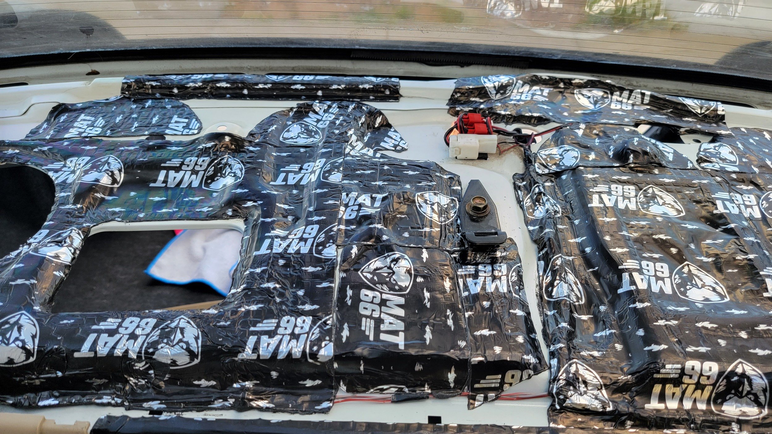

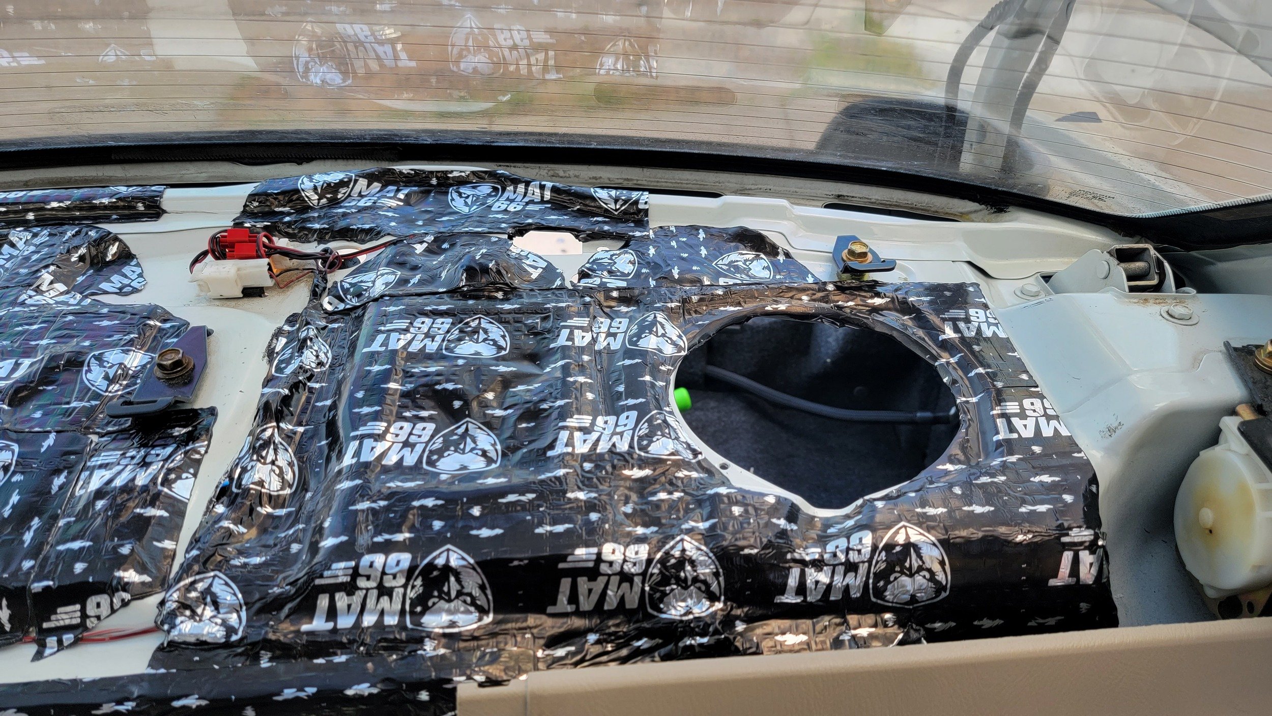

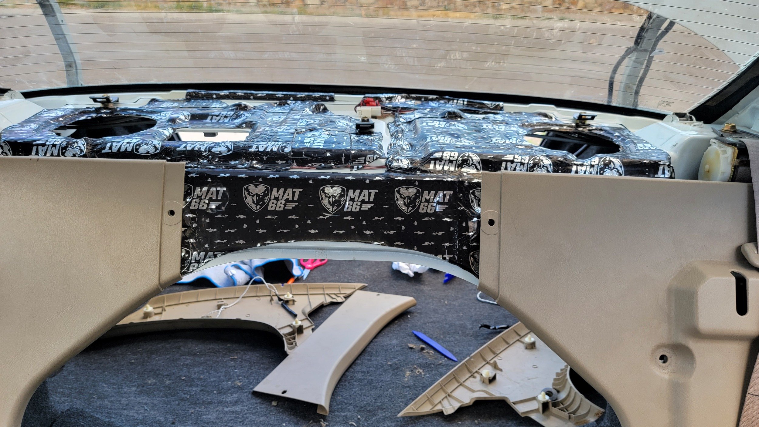

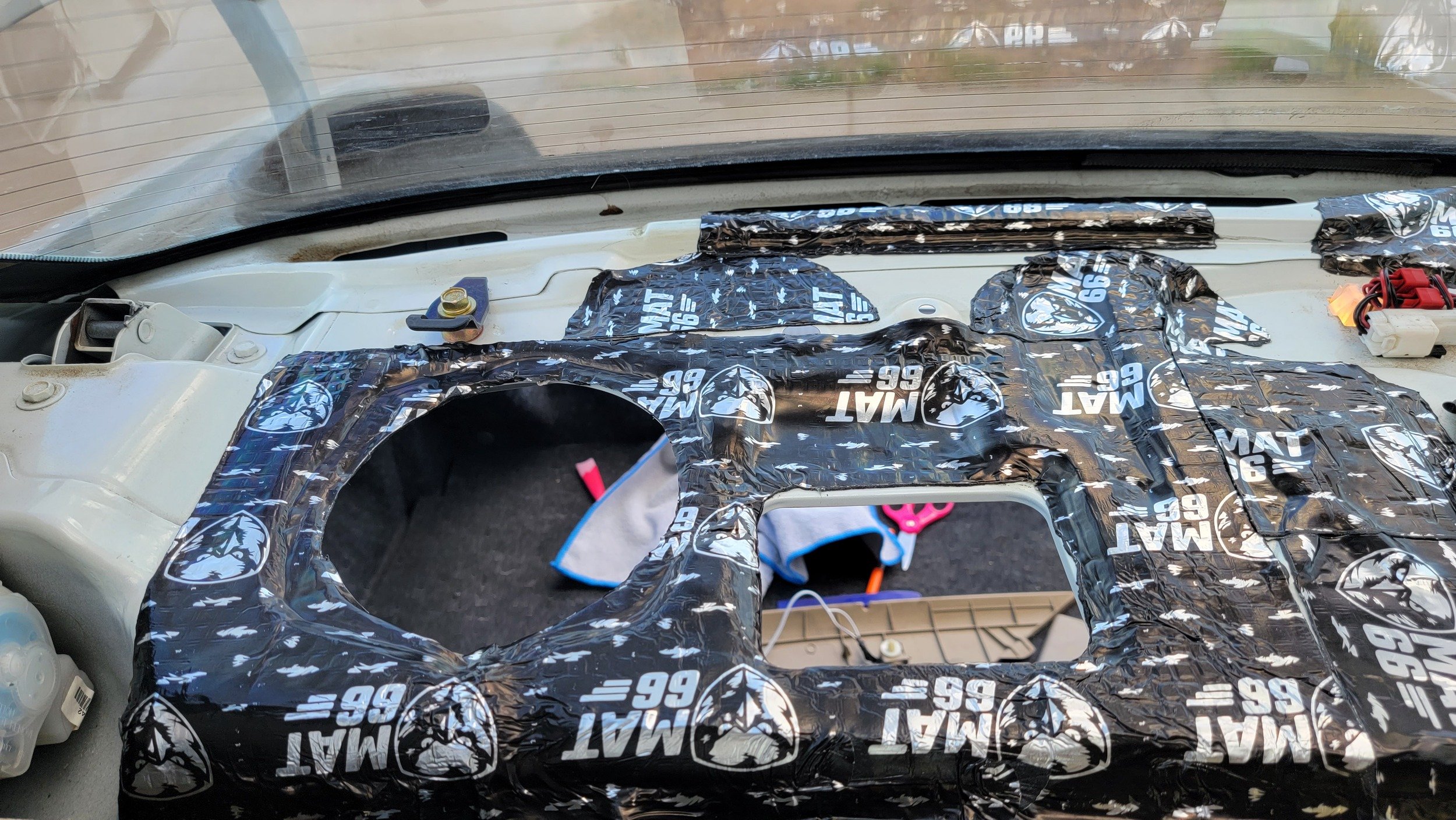

So I did the back deck to see how it would come out this is my first time ever doing sound better here's some pictures of the results. 20220805_183704.jpg20220805_183702.jpg20220805_183656.jpg20220805_183653.jpg20220805_183649.jpg
Would anyone like to provide any tips or feedback?

That looks so similar to my 06 Elantra. If it acts the same your headliner/roof will need deadening and go ahead and do the trunk lid and license plate area. The more deadening the better. 4-10's, she's gonna rattle.
I believe it has been proven that you get very diminishing returns from multiple layers or 100% coverage. Strategic placement on the largest and thinnest areas will give you the most improvement then save some for problem areas that reveal themselves after you put the subs in. If you're looking for a luxury car quiet ride you should consider working with MLV and CCF which should be full coverage. As far as keeping thin panels from rattling you shouldn't need to go overboard on deadening. Thicker will be better but I think even 80 can be a bit challenging to work with if you buy one with a thicker aluminum layer. I suspect anything thicker if they're making it now would be a lot of extra work to apply.
Sealing doors makes a bigger difference, as what you're trying to do is create a sealed box out of them to separate the rear wave from the front wave.
25 percent coverage in the center of the panel is considered "ideal" by most people for deadener. There are 2 other steps after deadening tho, isolation and blocking. Isolation and blocking are 100 percent coverage deals.
Isolation would be closed-cell foam sheet and blockage would be something like Mass-loaded-vinyl. You can get products that do both in 1.
