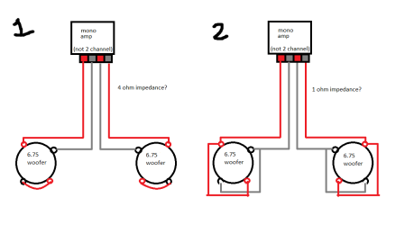

Attached is my wiring diagram
PART 1
Figure 1(left):
I plan on getting two Kicker 6.75 subs(150w RMS 4 ohm DVC) https://www.kicker.com/comp-rt-6-75-4-ohm-subwoofer with a Kicker amp https://www.kicker.com/CXA8001-800-Watt-Mono-Class-D-Subwoofer-Amp. From what I understand, the 2 positive outputs are connected and 2 negative outputs are connected on the amp because its a mono amp not 2 channel. So given this...
  1. Is the wiring correct for 4 ohm load?
  2. If wiring is good, the amp is sending both speakers 150w each right?
  3. This works?
Figure 2(right): These are the same subs but now with a weaker amp https://www.kicker.com/CXA4001-400-Watt-Mono-Class-D-Subwoofer-Amp.
  1. Is this wiring correct for 1 ohm load?
  2. If wiring is good, the amp is sending both speakers 200w each right?
  3. 200w is fine even if a little higher than sub RMS right?
  4. This works?

Okay here it goes.
First, not going to cover wiring example 1, Don’t worry about series for now; it’s not relevant here given the equipment you want to use.
Example 2 gives you a 1ohm load and is correct.
  1. If wiring is good, the amp is sending both speakers 200w each right?
Technically the output will be equal to both (all woofers in this setup) and will be the sum total of the amp’s output at any given volume relative to the amplifiers rated power devided by the total number of woofers. The amp does not see 1, 2 or 5 speakers, it sees all woofers as one speaker when using a mono configuration like this.
  1. 200w is fine even if a little higher than sub RMS right?
You listed an 800 watt Kicker amp that is 1ohm stable and it will be fine in this setup, but we’ll cover other options that may give you more for the same $$ or the same for less $$, later. So yes, this amp will work; I just think there are better options for the money. I always run amps that are rated higher than my subs for reasons we can cover later if need be. There are a lot more options at the $299 price that this amp is going for.
This works? Yes, this will work fine.
First off, welcome.
That wiring method is called parallel. With this method, the more speakers you wire, the lower the resistance gets.
  1. wiring is good, the amp is sending both speakers 150w each right?
  2. This works?
At 1 Ohm as described above, the amp is rated 800 watts. So 400 watts each sub. Too much, yes. So you lower the amplifier's output by adjusting the Gain. You want 300 watts for the combined RMS handling of the subs. The formula for that is

First off, welcome.
That wiring method is called parallel. With this method, the more speakers you wire, the lower the resistance gets. In your case it will be 2 Ohms. That is 4 Ohms divided by 2 voice coils.
At 2 Ohms as described above, the amp is rated 600 watts. So 300 watts each sub. Too much, yes. So you lower the amplifier's output by adjusting the Gain. You want 300 watts for the combined RMS handling of the subs. The formula for that is

Didn’t he say that he wanted to use 2, dual 4 ohm subs? Running both coils parallel then the two subs parallel you would end up with a 1 ohm load. Just don’t want to confuse the guy… ;)
