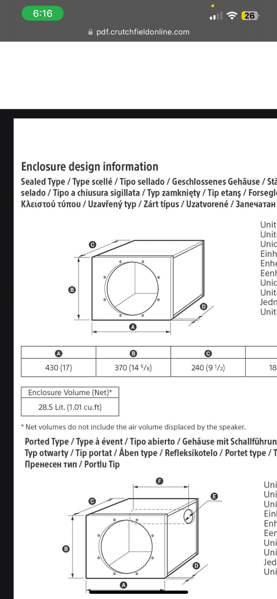

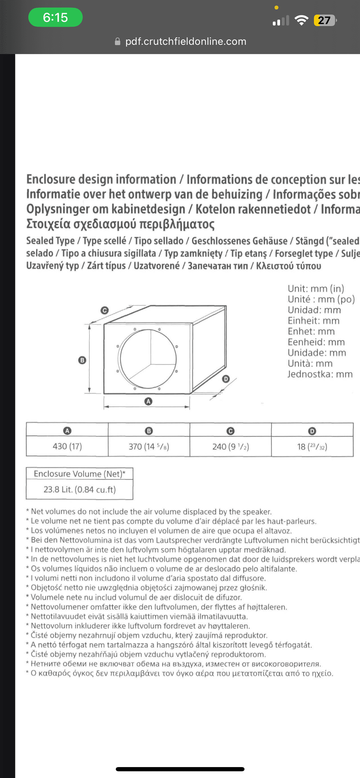

Not according to Sony. The 10 needs a larger enclosure.
The Sony manuals state 1.01cf for the 10”
…and .84cf for the 12”

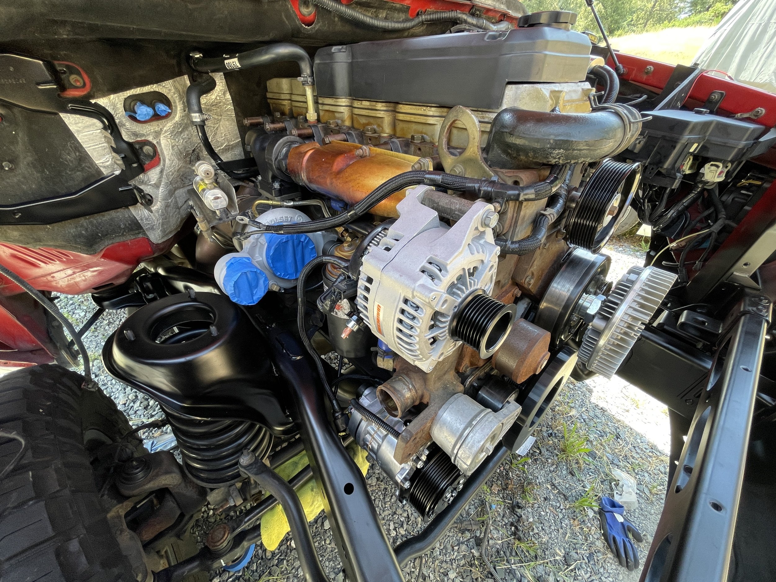

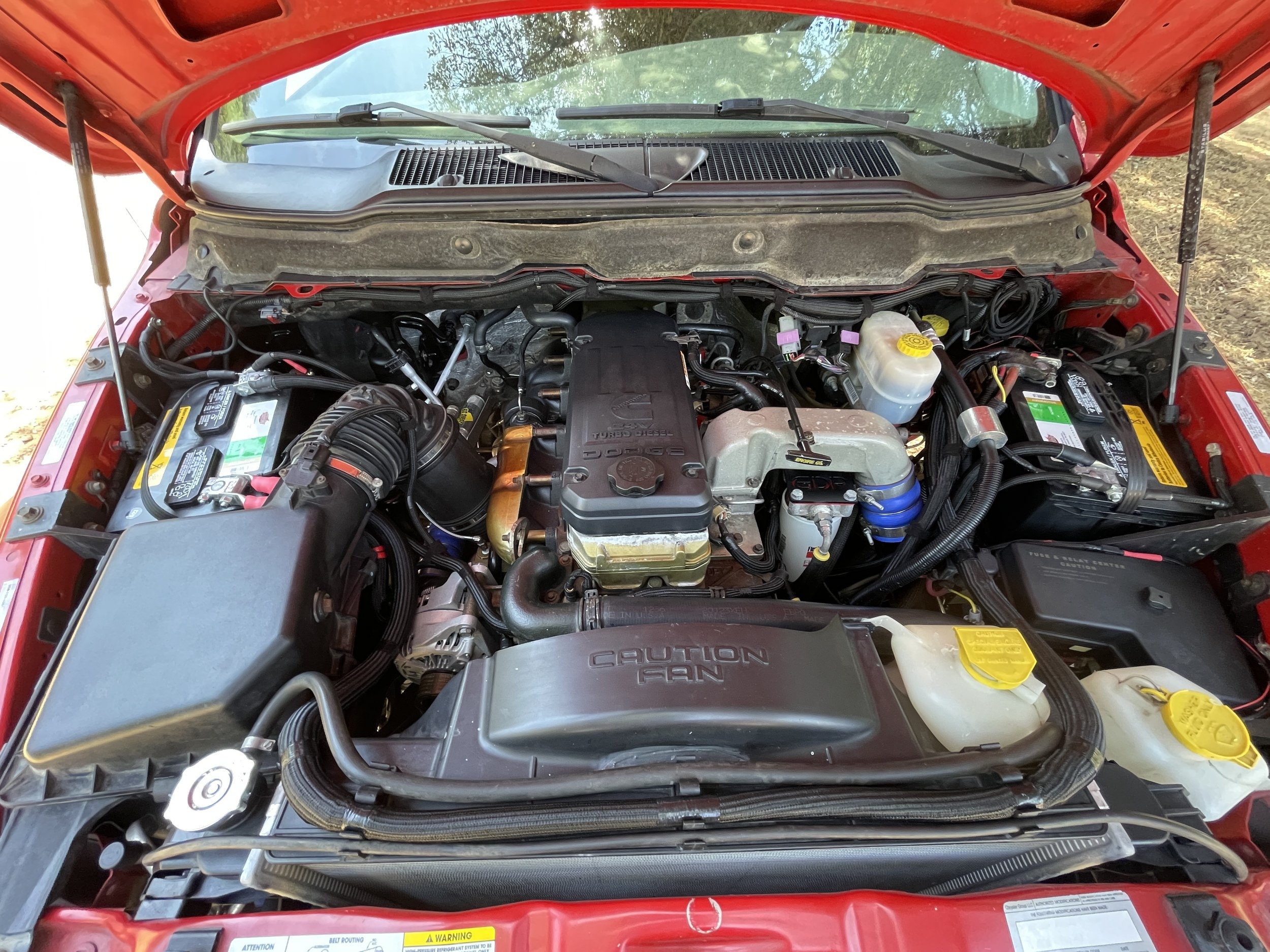

I already fortified the truck’s electrical system. It has a 370 amp Mechman alternator and 3/0 throughout. There’s a 3/0 to a junction on the firewall that’s waiting for future loads. I rewired a good portion of everything under the hood last spring.
