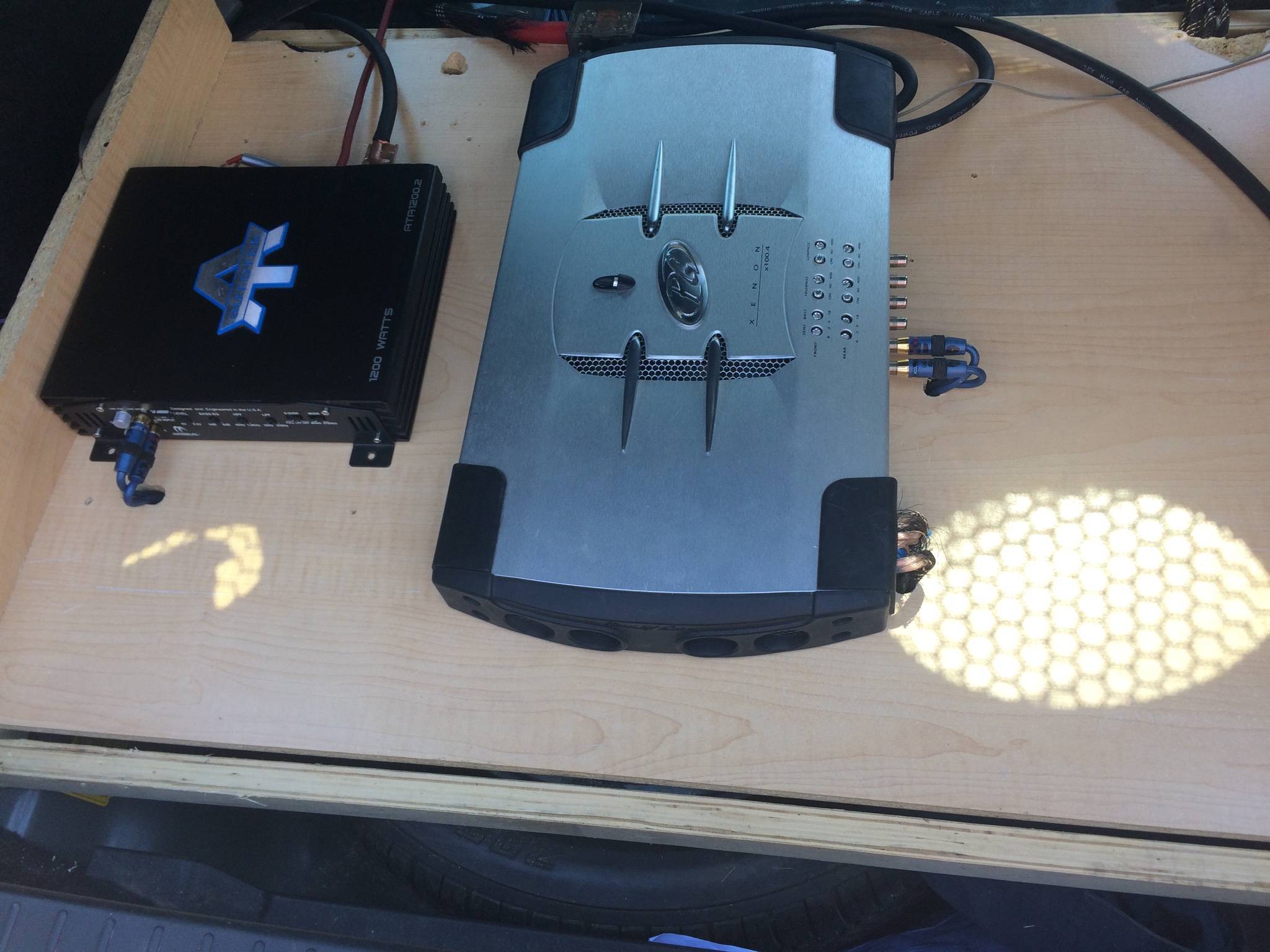

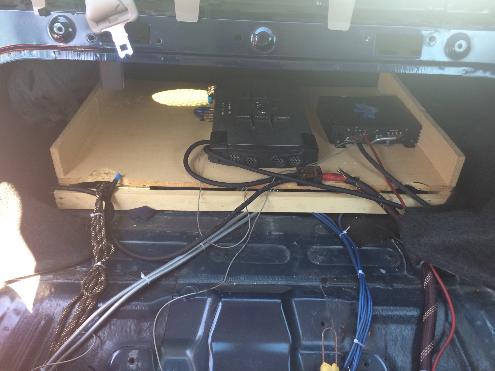

No sub for now, gotta organize cables on the false floor
Set the gains on the pg amp using a 1000hz 0db sine at volume 62. Ended up setting it to 10 oclock which is right around 5v which is what the hu outputs. Then i sat in the car, closed doors and windows and played deep house at max volume for 30 min which made for an interesting experience.. i was checking if the speakers got hot or started smelling but they didnt, therefore i can confirm gains are set to a reliable level.
Organized cables a bit..its not perfect but better than having a snake nest in your trunk

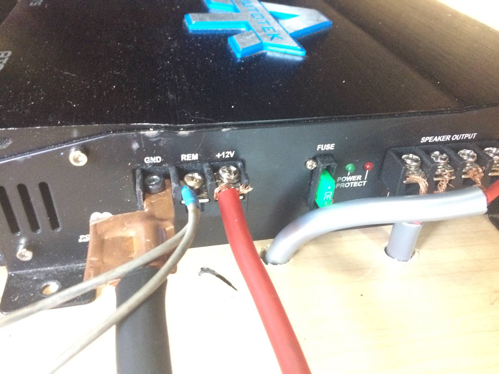

check out that homemade ghetto lug. Its solid.
