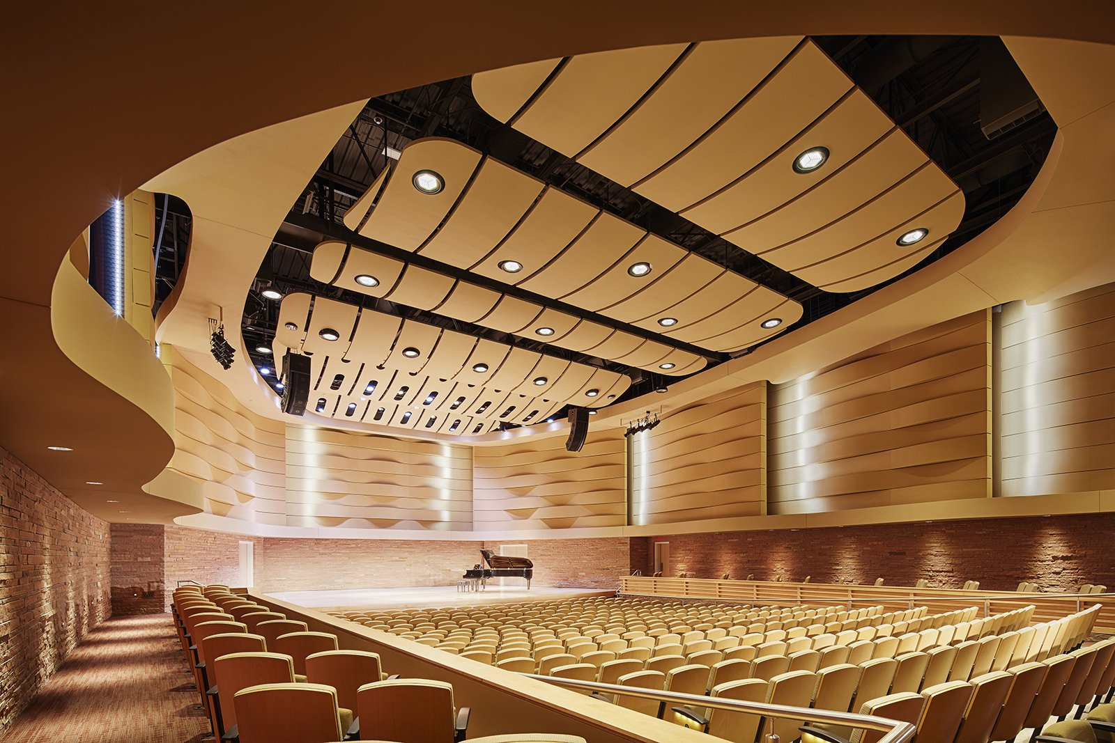

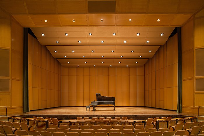

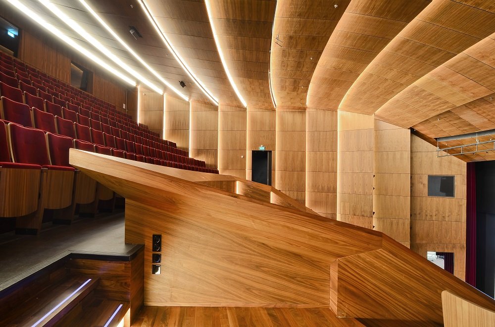

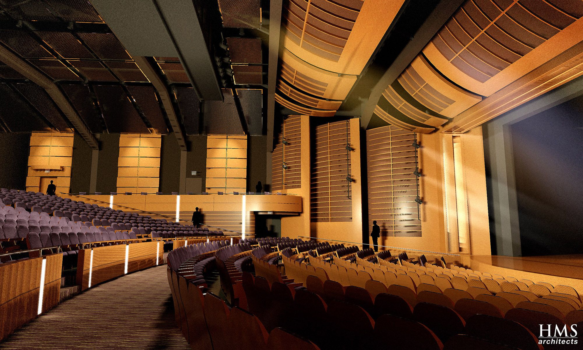

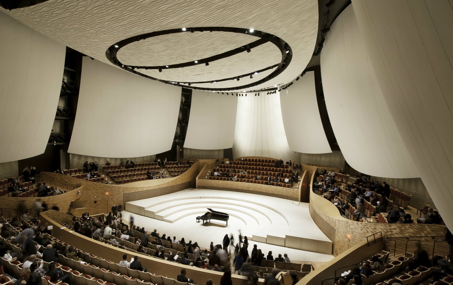

Imagine what it takes to design these enclosures:
The shape of those rooms would somewhat determine the electrical-impedance load on the amps as the speakers pressurized the room at any specific frequencies. Sound seems to be wild like that. That room design is part of acoustic coupling, controlling the way a wave spreads out, sort of like your port or cone/diagram shape.
