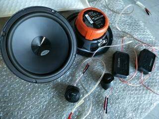

This may be an option for you as well. Im sure Amazon has them on theyre site also to be purchased. Great amps...
11
381
If you can find these in your area. Id recommend these for drop ins. They play from 40Htz on up. Sound very nice on amplified power for premium...
