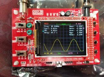

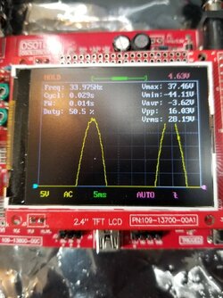

I have an older sony (cdx-gt130)single din. It says it has 2v preouts. I was checking the voltage output and signal to find where clipping is, the voltage at
30/40 v2.2+
35/40 v3+
37/40 v4+
38 is clipping
The headunit on its way out, im lost. Loudness is off fyi.

where are you getting these voltage readings from? also, loudness doesnt increase the output voltage past the physical capability of the unit itself. If its says 2 volts and puts out 4 with loudness on, believe me theyd call it a 4v deck
From the ends on the rca that would go in to the amp. I had all settings zeroed when testing. Ill test again and post a vid.
Useing a budget oscope.
not sure how accurate that is then, but its entirely possible. to be safe, you should set the gains according to the reading on the o-scope and if you can, try to verify voltage via a DMM, however youre not going to hurt anything having the gains lower than versus if they are set too high
Which tone did you check the RCA voltage from HU? I just literally watched an EXO vid of him tuning someone's system and he did the same exact thing. Pretty good. You're leaving a few details out of the issue here.
Also I don't know if I would trust a budget oscope. Like youdofus said, I would be concerned if a company rated pre out RCA's as 2v and you checked them and got 4. So who's lying?!

Had time to retest, feel dumb now.. *sigh* i dont know what i did in the first testing. This go around i oscope the rca with -5db 40hz and ran the volume knob to 50 and no clipping and reset amp gains.
Thanks
