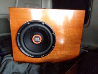

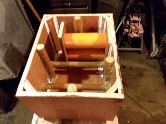

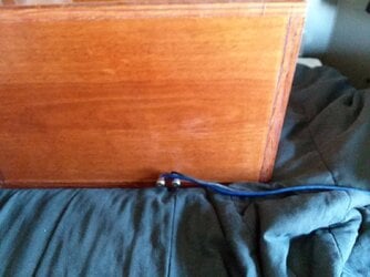

So I had some wood and plenty of dowel left over from a previous build and a jbl s3. I didn't put a lot of effort into trying to be neat with it since i wasn't sure I'd like it plus scrap wood. kinda thought it might be a throw away but I've been contemplating trying a higher tuned box and why not considering 99 % of the music I listen to doesn't go below 40hz.
Pleasantly surprised by just how much I like it. Currently have it on my k1000 at 4 ohms. 1.49 after displacements. I've had this sub in a couple of different boxes from 30 to 33 Hz tune but i must say for what I listen to this is my favorite box for this sub..

Just never really know what you'll like till ya try it. I had my doubts lol.. I see so many comments saying I would never tune over 3@ fill in the blank hz. Seen where you tried it a while back and thought I'd give it a try some time. Jbl looked like a good candidate out of the subs I have. Sure makes it easier to fit the port lol. So yeah thanks for the inspiration definitely love how it turned out

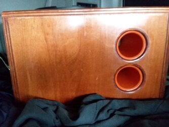

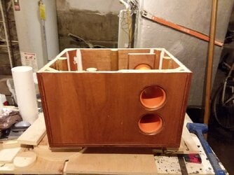

Also, good looking box, OP.  I've never had good results with multiple round ports myself but for what that sub is I don't suppose you're chasing 10ths on the meter.
Lol yeah low powered more of an sq sub not gotten into the whole spl side of it plus i was leaving myself an out in case i didn't like it i could plug a port and drop it down to around 30 not ideal port area for it with 1 plugged but I've built a total fail box b 4. Not getting any use out of one *****.

Nice box. I'm at 40 hz and love it. I used to have dual 3" ports but switched to a single 3". I gained more air velocity and couldn't be happier.
Thanks for the compliment. If I was to do it over (which I probably will at some point) I would use a single 4. It does pretty good for what it is. I think it's a nice sounding sub. I like the higher tune better for what I listen to.
