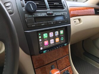

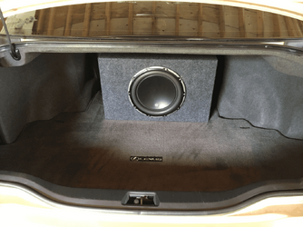

About a year ago I installed what I think is a pretty respectable system in my Lexus LS430. It's got an Alpine ILX-207 head unit with Focal speakers up front, Infinity Kappas in the rear, both powered by an Alpine 4 channel amp. In the trunk I have a JL 12W6v2 powered by a Rockford 500/1. Pretty muc the whole car has been sound deadened.
My issue is this -- I just got offered a JL 12w7 for stupid cheap and I basically cannot pass it up. My only reservation is that to my understanding this thing would need at minimum ~800 RMS and I definitely am not willing to upgrade or in any way modify my Lexus' electrical system (stock alternator is 130 amps). As of right now the lights don't dim whatsoever even when the bass hits. Do you think I'll need to upgrade my electrical to power this sub? In the same vein, for those who have owned both the W6 and W7, is it worth the extra money I'll need to spend for another box and amplifier? Thanks in advance.
Personally yes I would run the w7. But you also need a an amp capable of 1000w at 3ohms. Jl and their BS single 3ohm voice coils. I have a 12w6v2 in a 1.6 cube sealed box. It's pretty decent, but not enough for my uses. The 10w7 I put in a buddies box in 1.5 ported box was definitely better.
W7, ported box, feed it a good 1000W.   There should be a few options for 1000-1500@ 2 ohm (Kicker, JL, or assorted Brazilian offerings), all of which should get by on stock charging if you really aren't going hard on it all the time.
Keep in mind if you're not going to buy/build a proper ported box you won't really get great results, and working out of a trunk is brutal.  You're leaving 5-6dB on the table vs the same gear in a hatchback or SUV or other open cabin type vehicle.

Well I removed the stock 8 inch sub that was an infinite baffle on the rear deck, so there is an open hole going from the trunk into the cabin already. It’s covered by the stock sub grill so it still looks oem.

Thank you guys for the insight, I really appreciate it. I’m gonna go ahead with the W7 — shopping for an amp now that’s both small enough to fit into the place I hid my Rockford and powerful enough to drive this beast
