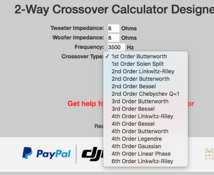

I was reading up on building my own crossovers and Jesus it went over my head...
I just need to find a calculator like you said that will tell me what crossover components to buy and how to assemble them cause $50 for crossovers is a bit much IMO.
https://www.diyaudioandvideo.com/Calculator/SpeakerCrossover/
Super easy, just plug in your crossover point and impedance and it spits out component values and schematic.   Really doing 2nd order long-hand isn't tough, but it's unnecessary.... I had an old Texas Instruments calculator back in the 90s that would do what that page does.
