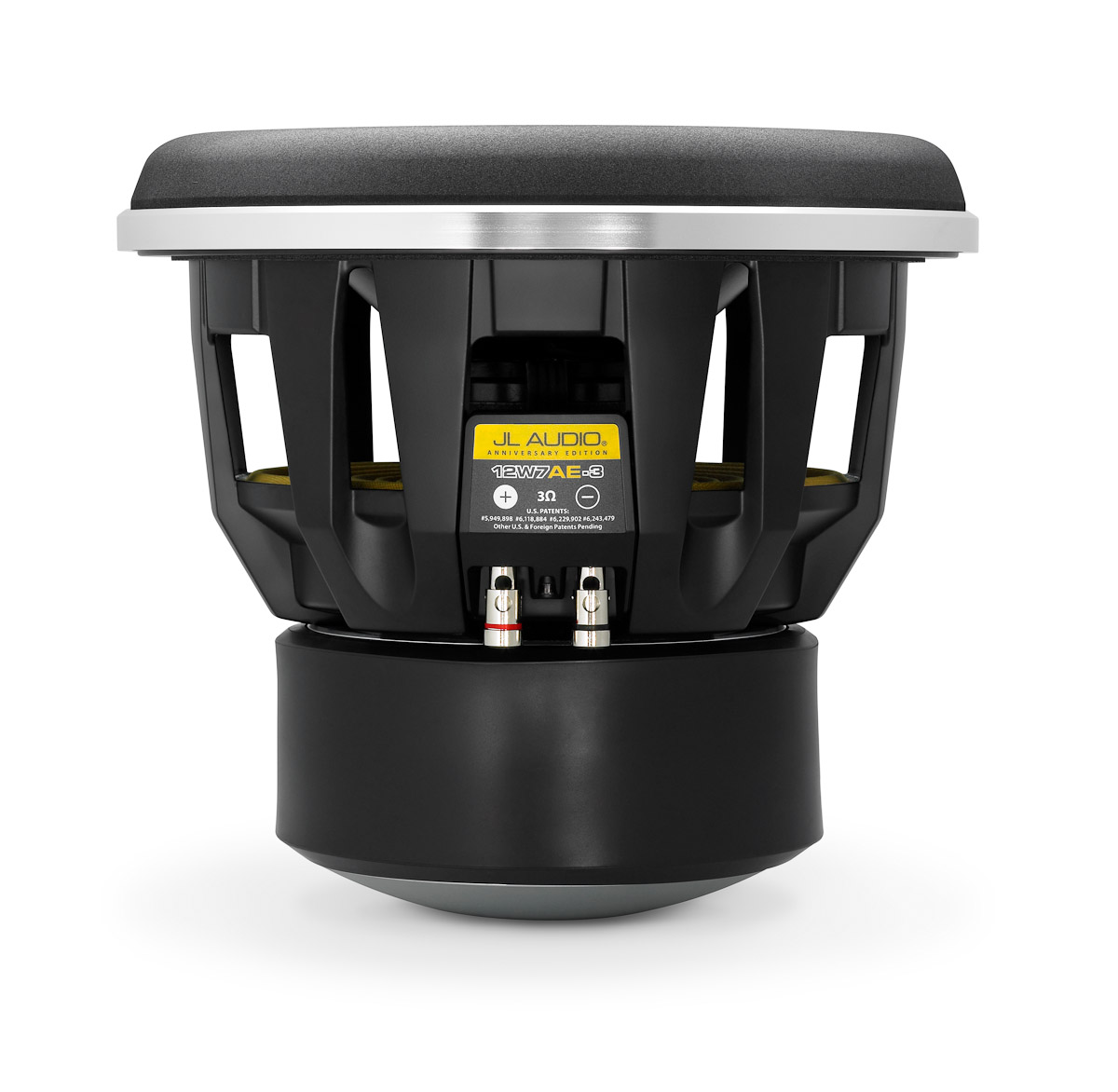

I have an f250 that im wanting to put subs in. I have enough room for a box that could have a maximum of 2.75 cu. ft. Im more into spl more than a sq. and listen mostly to rap I was thinking either 2 12w7's or 5 10w6's. Open to any other suggestions

2.75 internal. It’s a crew cab. I was planning on a 1000.1 for each of the 12w7s and not sure for the w6’s. I was going to do a sealed box and for the 12W7 it said it required 1.3 cu per sub and the 10w6 needs .55 per sub. I moved my rear seat forward 3.5inches and I was going to put them behind the seats

Dunno what they like sealed but the published number is likely minimum.  W7 is going to require a lot of mounting depth so "behind the seat" doesn't sound like it's going to happen, but get out your tape measure and compare to published mounting depth specs..  If you're going to just cram as much cone area as you can into a sealed box  and like the JL lineup do consider their shallow mount line.  Might be a bit more practical for mounting depth.
After moving the seat forward and ripping the carpet and stuff on the back bulkhead I have 12” at the bottom and 7.5” at the top. The 12w7 has a mounting depth of 9.5 with a .5” clearance needed for the pole vent so if I mount them  low enough in the wedge box I’ll have the clearance. I’ve had a bunch of different setups (4 8” Sundown, 4 10W3’s, 2 12W3’s, 3 12w6’s, 4 10TW3’s, and 4 of the first flat 10s punch came out with ) I think the shallow mounts are good but with the 12W6s it felt like someone was sitting on your chest is the best way I could describe it and I never got that with the shallow mounts.
Will that leave enough room in front of the subs that the surrounds/cones won't rub on the seat back?

Yeah I think the excursion is about an inch so I took an inch of the box so it would clear
How much frame and surround sticks out from mounting surface + the actual cone movement.   You really really don't want to rip up the surround on your seat.  Double-triple check.
