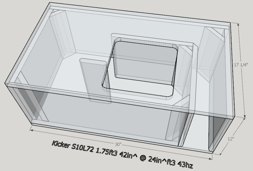

Got this collecting dust, I dug it out and cleaned it up...
It's a little out of warranty so I thought I'd try throwing this on it at 1 ohm...
5yKj36H.jpg?1
Got all the tools and enough spare wood just sitting around... hey why not?
Not really trying for that under 40hz information... it's a Kicker... ought to rock
I'm tired of just doing designs... time to build one again.
This'll be fun.

That box has potential to do fairly well on the meter for its cone area on lower power.

Heck yea. I miss building nice rectangle boxes hahaha... havent built a nice simple box in a while! Everything has been crazy shaped or kerfed...

Nice clean simple box shredder. As soon as I saw the post I thought to myself it was going to be a standard slotted port with a 45 on every single corner.
The blow through your helped me design is doing great it's getting only about 500-600 watts right now doing 146.2@46
