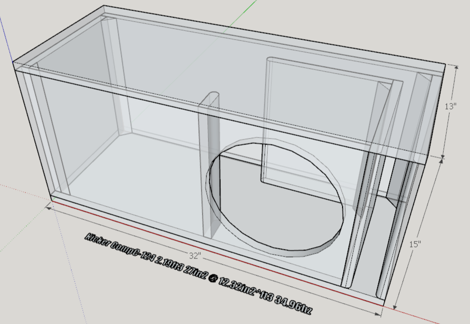

I'd get a 5ch amp with about 300 watts on the sub channel and go with the CompC personally, and you'll be able to have your highs properly amped too it'll sound WAY better IMO. Build a box that will get you some lows (it'll still be punchy AF but not so bad). At least Kicker is a known quantity and I've done some Comp 12's that made the owner smile before.
As far as the Rockville site goes I'm not sure what's available but even 300 watts done properly can sound good to most people.
Just avoid the prefabs with a Kicker unless you want to lose that under 40hz information... lol
IDK... maybe like this...
I'm out.
I'm out.

Torres box calculator works great, as far as apps go I'd use Ultimate Audio app for box design (I'd keep it around 12in2^ft3 of port for lower power/lower level sub, or 6-8in2^ft3 of port if using a round) of course I'd recommend modeling it up but using BB6 or Winisd might be a bit much for the beginner.
