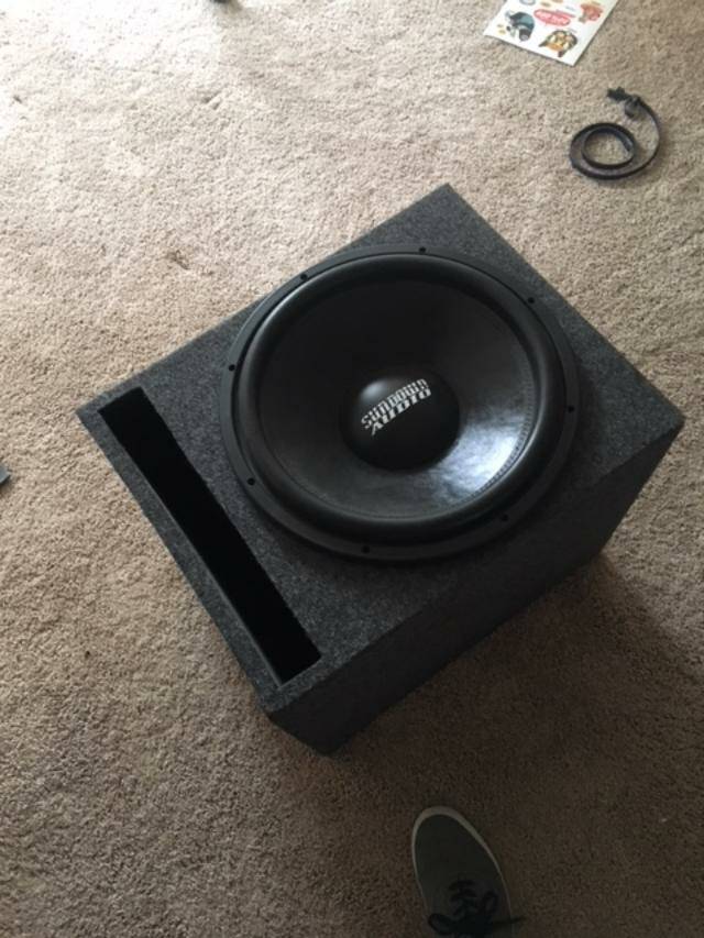

This is a pic of the sub in the enclosure I'm picking it up Thursday. Definitely a prefab

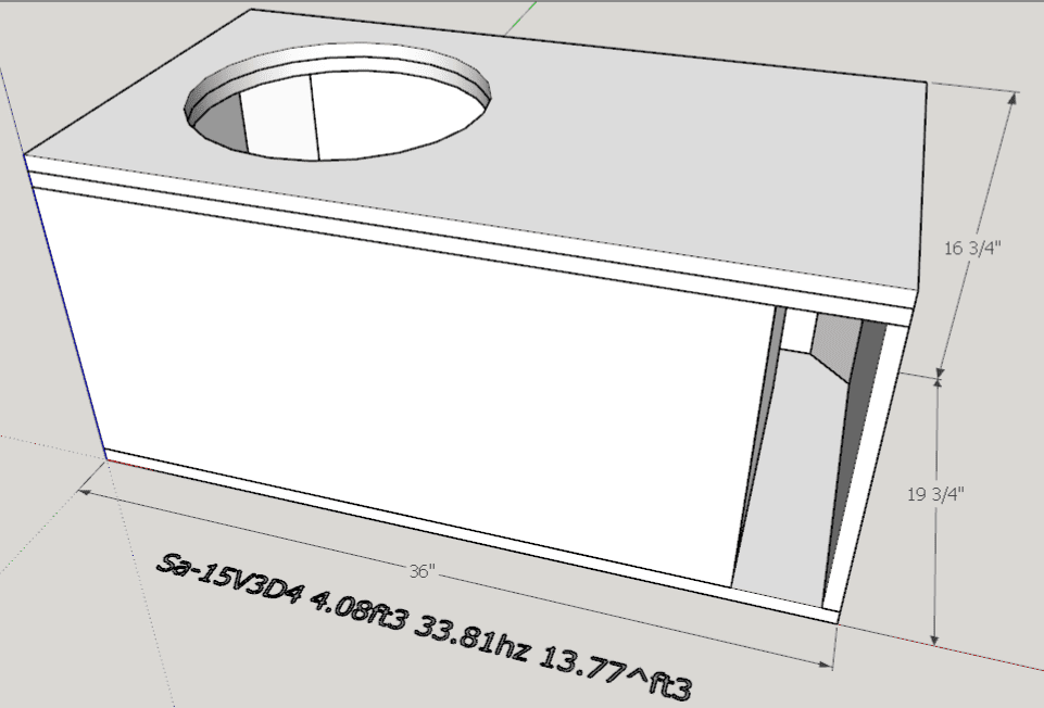

IMO a mid-low 30's tune at about 4ft3 net should be about right... I was playing around and modeled it up for your power.
This is what I came up with...
Hope that helps.
If you'd like me to try for a different configuration lemme know... I just drew that one up quick for an Suv.
IMO a mid-low 30's tune at about 4ft3 net should be about right... I was playing around and modeled it up for your power.This is what I came up with...
Hope that helps.
Sweet thanks, I would most definitely need to fire the sub up and the port either towards the passenger doors or up. The sub is going the the backseat of a 2014 Silverado. The max I can have to clear the doors to get a box in is 17-18 inches. And 36 inches would be my max width. If you feel like posting another that would be appreciated
