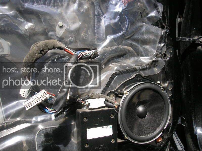

In the 97-00 QX4's, the crossovers are in the doors AFTER the amp.
Heres my 99 QX4 door taken apart, ignore the JBL speaker (thats definitely not bose) but look at the Bose crossover next to it.
I can't say anything for 01-04 (WOT?) because ive never taken those years apart.
thats the bose amp. as i have said there is a clean low level unmolested signal just tap behind the radio or before the amp no need for LOC, just splice rca ends in
