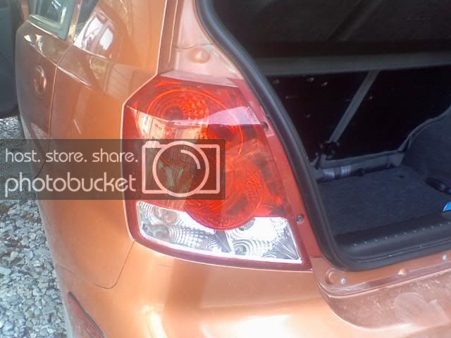

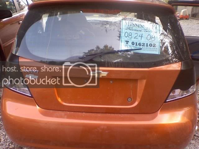

my gf got a Aveo.. she wanted somethin that gets better than the 11mpg her ***** Am got, so we picked up a used Aveo wit 38,xxxmiles for under 7thousand bucks.. and she wanted me 2 tint the tails.. so here's my handywork
before

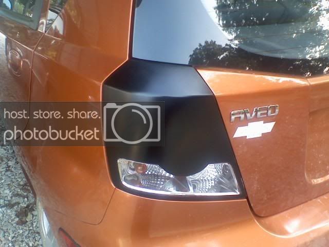

after

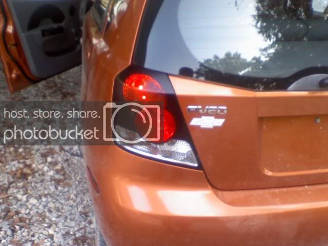

lit up

I like the 2tone look, the reverse lights and blinkers are hella bright...
I just got some plastic spray paint.. duplicolor.. and taped em off, no scuffing or anything, just sprayed a few light coats til i liked the darkness, let em dry and put em in.. same stuff and method i used on my car.. and paint has held up outstandingly for nearly 6months

thanks guys, i like the clear/blk look too.. thats wut she wanted so thats wut i didt.. i think i did a kickass job wit the tape lines.. i tore the tape into TINY pieces to get the round corners.. then took a hard plastic gift card and straightened the lines out as best i could..
