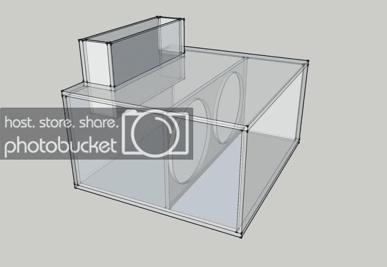

This is designed with the dimensions you gave me. 4.1 cubes sealed, 5.7 cubes ported, 120in^ of port tuned to 49hz. Now that would be loud as hell with 2 BTL 15s in that little car.
Was just a rough guess. I think it goes 6" above the top of the box.
no i am just saying front to back of the box.. it looks like it would come past the rear deck then come up.. i gotta find my measurements again.. mltrass only has 8.2 in his.. so one of mine is wrong..
