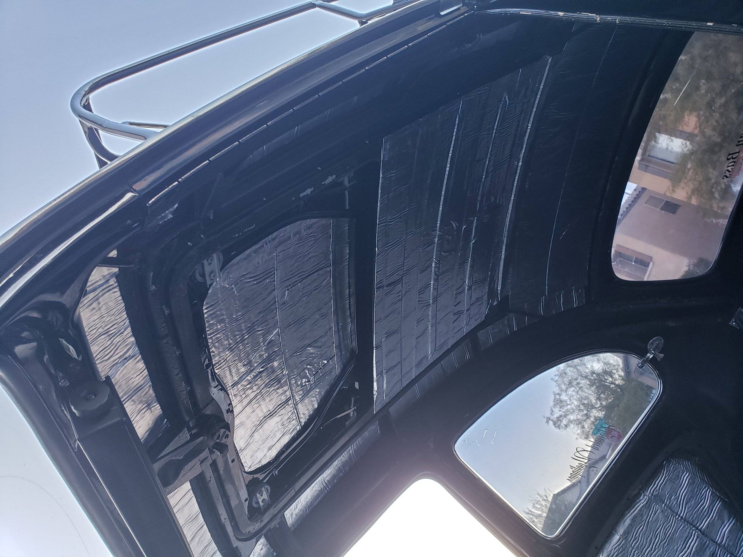

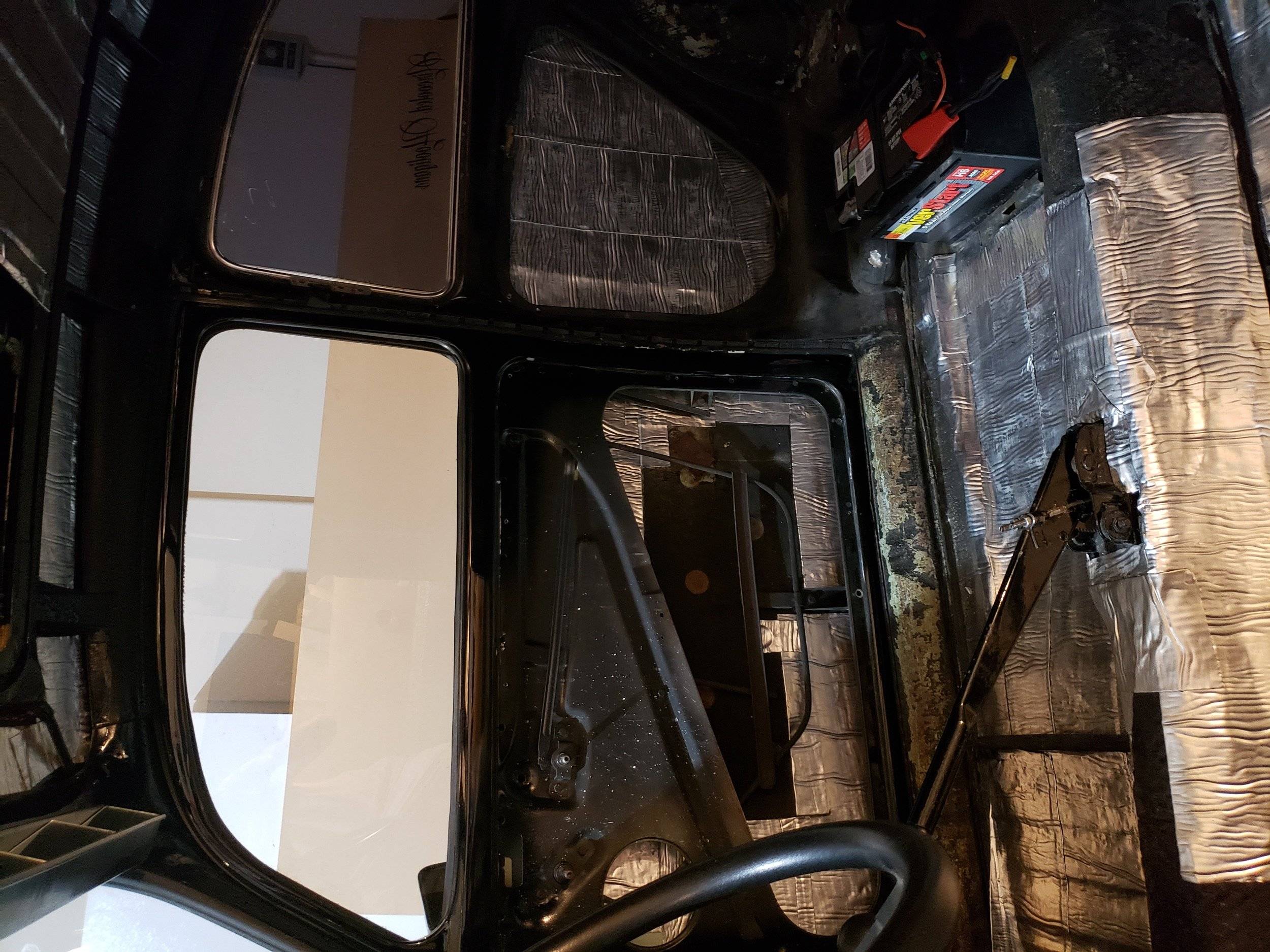

Have you gotten any kind of deadner or bracing for the roof cavity done?Looks like a 2 seater ride mainly to me.My Honest opinion..One good 6.5 mid bass and a 3.5-5.25 midrange and one good 1" tweet should be plenty to keep up with a single 12 -15" sub on 2k.rms

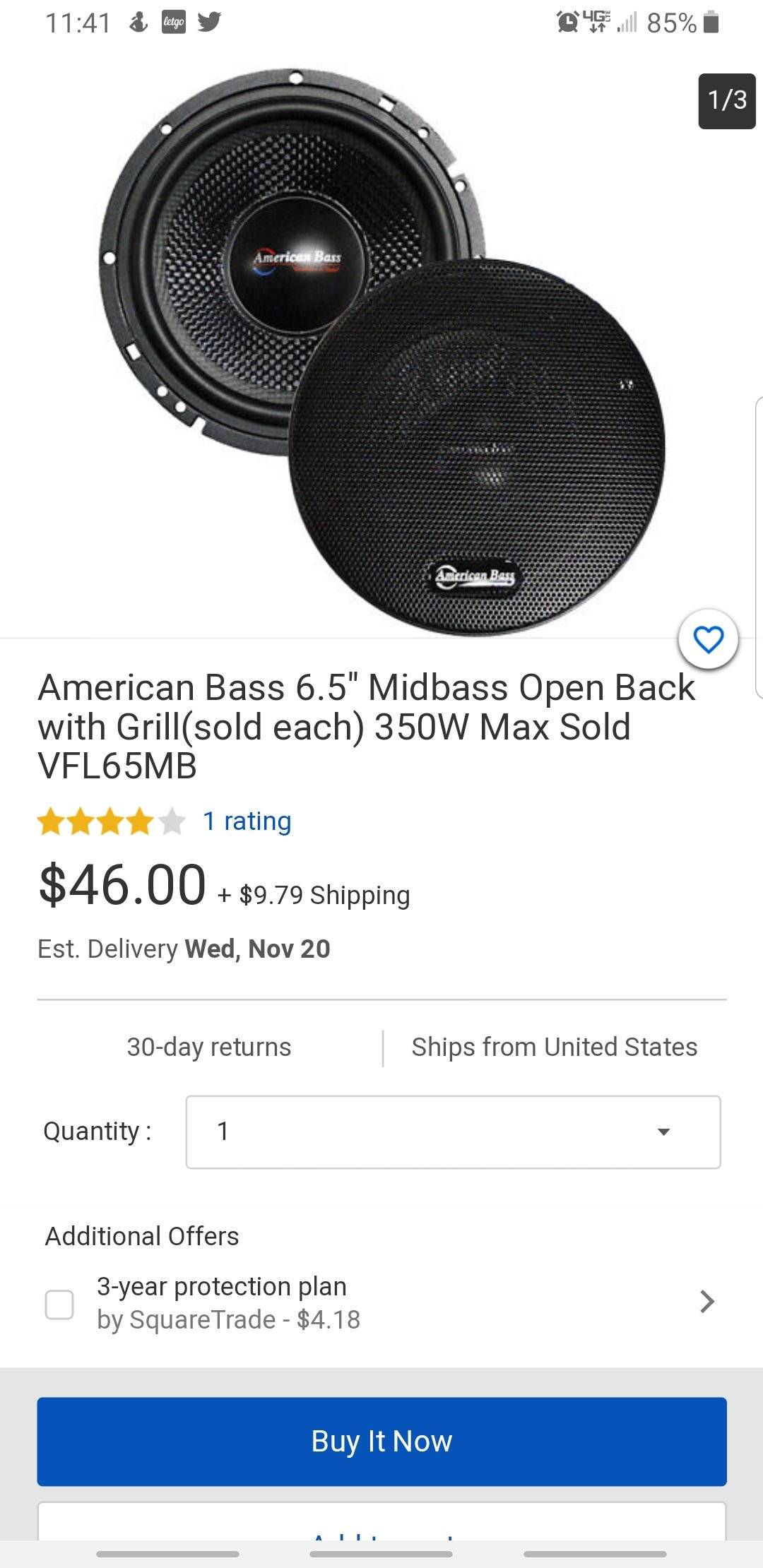

I was thinking about two of these.
poor choice, weak midbass extension, no different from your pioneer. It says midbass on the name but its not really a real midbass driver its the same PA midrange design and performance.

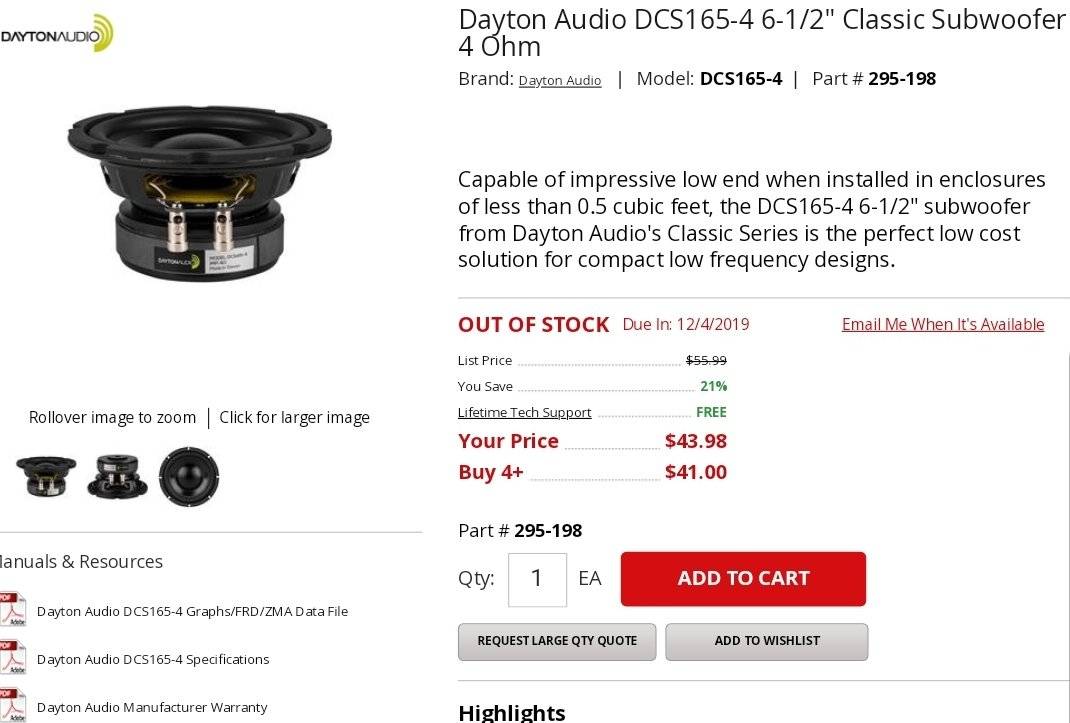

Is this better, or, the same? Any suggestions? I think it gets down to 36, on paper anyway.
Yes. I’m thinking of using Dayton drivers as my midbass as well. I’ve used them in home speaker systems, but never in the car. You won’t need them to dip down to 36 hz anyway, since you will have them on a crossover.
