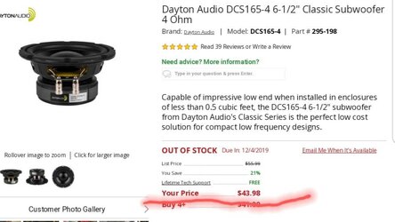

The Dayton has 8 channels. So, my thought process was two channels for the tweeters, one channel for thel midrange, one channel for the midbass, two channels empty, and two channels for the sub. Midbass in the door and midrange on a deck in the rear. I'm single, 50, and divorced. So, I have a lot of time to think/over think stuff. I was just thinking it would give my system a wider range of frequencies. These Daytons look nice and get down to 36hz. and are 4 ohm.
