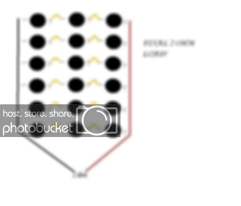

yeah your better off going with 32
Incorrect, 36 is the best way to do it... if you want to utilize the most subwoofers and still have a 2ohm load per strapped pair...
~Wire a trio (3) in series = 12ohms (3 speakers)
~Wire three trios in parallel = 4ohms (9 speakers)
(Now duplicate this, making two groups of 9 speakers)
~Wire the two groups of 9, in parallel = 2ohm load (18 speakers total)
Wire this to a pair of SAZ3000d's strapped. Bam, 1ohm load per amp. Assuming an underrated 6000rms, this will be 333.33 watts rms per sub underrated.
Duplicate this for the second strapped pair of SAZ3000d's, and you have 36 10's and 12,000 watts... //content.invisioncic.com/y282845/emoticons/smile.gif.1ebc41e1811405b213edfc4622c41e27.gif
kthnxbi.

ok heres my Diagram....

//content.invisioncic.com/y282845/emoticons/wow.gif.23d729408e9177caa2a0ed6a2ba6588e.gif fuggin engineer
x2. WTF? //content.invisioncic.com/y282845/emoticons/wow.gif.23d729408e9177caa2a0ed6a2ba6588e.gif
lol, Its not your build so dont trip... Let me drop off 40 woofer's at your house and watch you wire them up without scratching your head...//content.invisioncic.com/y282845/emoticons/rolleyes.gif.c1fef805e9d1464d377451cd5bc18bfb.gif
That final diagram is actually quite simple...just run a couple busbars (+ and -) and then series the subs and go back to the busbars, nice //content.invisioncic.com/y282845/emoticons/smile.gif.1ebc41e1811405b213edfc4622c41e27.gif
