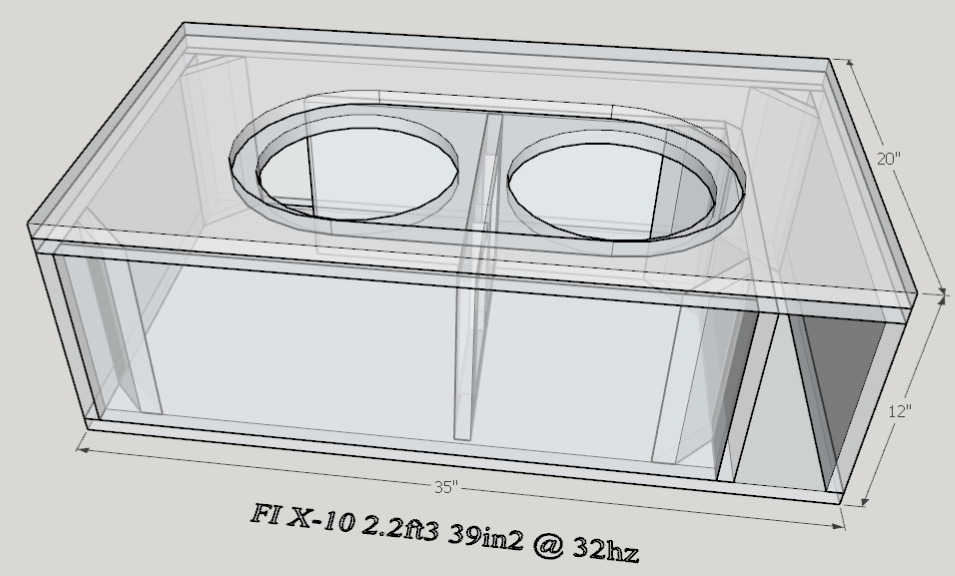

Here's a hatch/suv box that illustrates the potential size /w/ a slot and few compromises on your power...
An aero limits you, (a regular round unflared even more) to either too much or maybe enough port in certain cases and this might be one of those times... in this case even if its a trunk I'd suggest a properly sized slot. The FI X-10's will be worth the extra cost imo and get low and loud. (worth the wait they say... I always hated the FI wait myself... and ship cost).
Don't let the enclosure size scare you... most applications have a solution.
For those X-10's around 3ft3 even gross is doable imo so its close... that one above is 3.5ft3 gross without much in the way of compromises. Most enclosures are a collection of compromises anyways. A designer can help.
Its only 2 10's after all.
