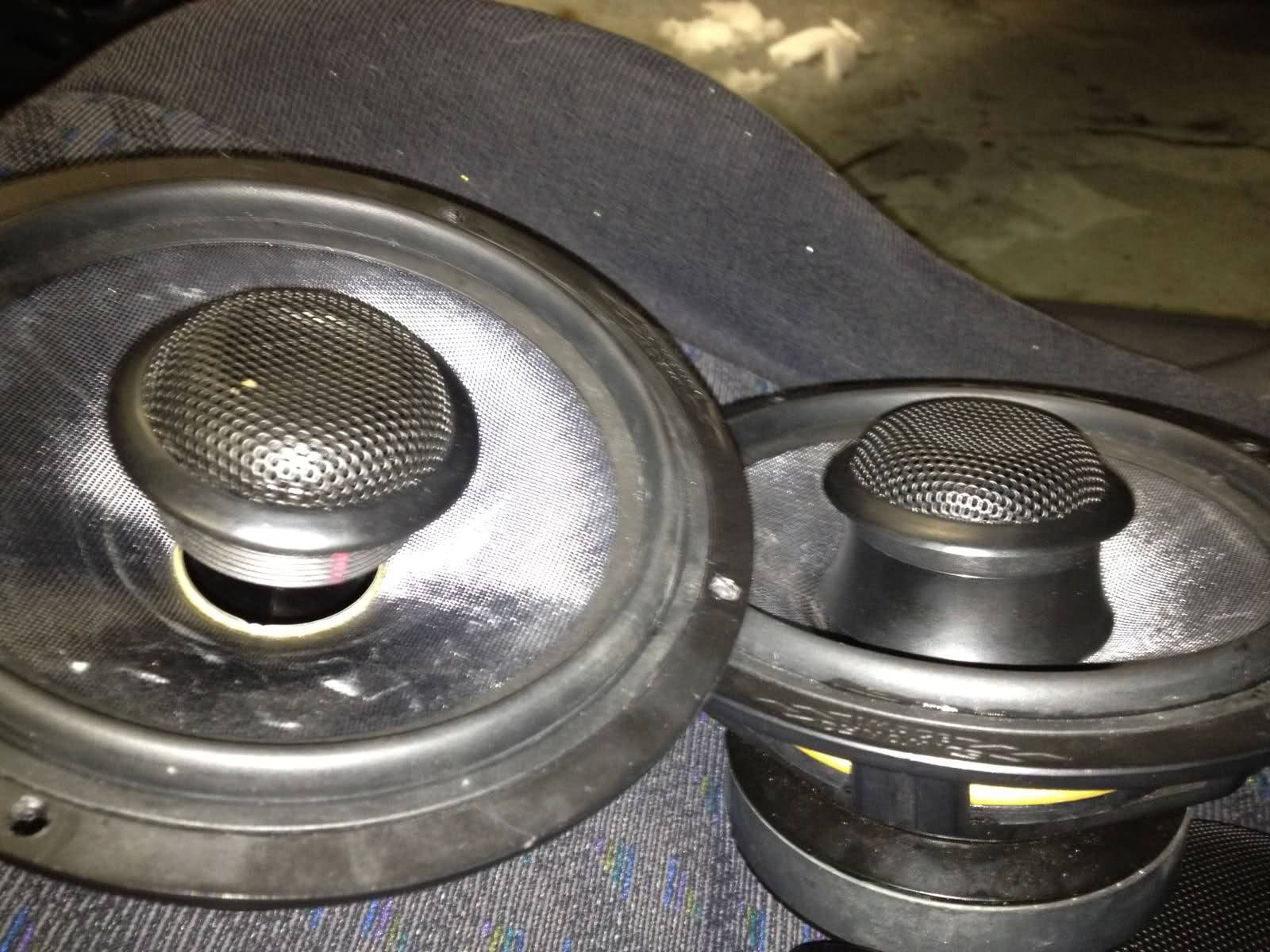

After ten minutes of fiddeling around with the speakers, me and my friend noticed that the right speaker had the tweeter screwed down so much that the bracked was touching the woofer itself, so it couldn't "bounce".
While the left speaker had a room to "bounce".
This must be some kind of a factory flaw(couldn't find a better word, my english dictonary subscribtion is outdated), but I was thinking if it would be okay to just take of the bracket, or is it supposed to be there to "guide" the sound in one direction?
He's a picture of the two speakers, the one that had the bad sound with the bracket off and the one on the left side that was working fine.
