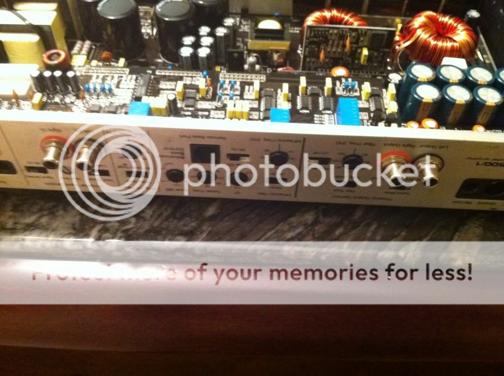

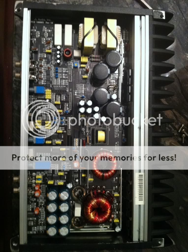

    Hello guys, I have a problem with my JL Audio 500/1 amp. The subwoofer sometimes plays and sometimes it doesnt. I looked into it and when i switch aux ports, it works at the 2nd one but with alot of extra noise, and a bit of distortion (Yes, i tried changing out the aux cable, still the same problem). The first one works, but only sometimes. I just opened it up, but i have no idea where to go from here lol. Here are some pics:
    And the ports:
    Any help would be much appreciated, thanks!

    hmm.. i use ones that say left ch and right ch (Which only works sometimes). But if i switch them over to the left output/right output they work, but with an extra noise, and a small bit of distortion
    To be honest, the panel in the back had only 2 screws in place, the middle and left. The middle one was stripped so i had to use a screw extractor to take it out. Is there anyway that this couldve been an issue? Sorry im a noob at this lol..

    The outputs are supposed to be used for sending signal to another amplifier not as inputs. Leave the RCAs connected to the inputs. If the amp is cutting out the most likely problem is voltage drop, if the voltage drops below 10VDC at the amp, it will shut off then restart when the voltage returns to a safe level. It could also be a bad ground, or short in the speaker wires. Does the thermal or low Ω light come on when the amp shuts off?

    The amp stays on, the power light stays on. And those 2 other lights never came on. The ground we changed 3 times, its perfectly grounded. The speaker wires are fine. Everything seems fine, except the aux ports.. (Which i already changed the aux cables). When im driving it just randomly stops playing (The amp stays on). I drilled the amp to the back of the seat that folds, and when folded down, it works sometimes, with the seat up, it works rarely. I hit a bump and it has a high chance of shutting off. Im thinking its something in the amp thats loose? Im not sure.. Any help is much appreciated, again.

    UPDATE: It seems that one screw was missing from the back panel, i replaced all 3 of them, and I'm not sure but the amp seems to work perfectly fine now.. Ill have to drive around some more to confirm that.. (There were 3 screws on the back panel, 1 was stripped and 1 was intact, 1 was missing as well, so i replaced all 3) Im clueless right now, but happy lol..
