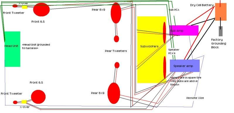

    Here is a rough outline of my system.

    Re: Yup it's another engine whine thread, 2 Culprits left
    buy a noise filter, and put it in your stereo power line, works almost every-time if that doesn't work check your grounds, if need be resort to ground loop isolators.
    read the post above the diagram......
