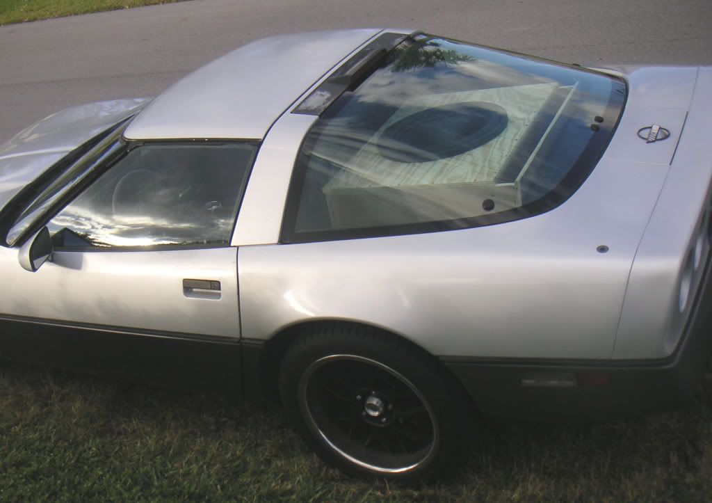

    i had a re sx 18" in 5.5 cubes net tuned to 34hz in my vette - on 1200watts it was insane. fiberglass cars do not flex - i realley miss that car and setup.
    i was prett stupid still back then when i had that car - and put a optima yellow top under the hood - still had voltage issues and put a kenetik 800 size battery in one of the behind the seat compartments back there and was good.
    but optima batterys are terrible - and one good agm battery up front would have kept me going.
    That looks awesome
