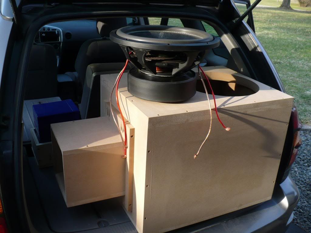

    I'd like to report back that I built a proper box for my HDC4, 4 cubes 36 hertz and on a Sundown SAZ1500dv2 at .5 ohm, it REALLY moves and produces a tremendous amount of bass. I hammered on it for about a half hour straight and it didn't get warm at all. I'm not sure if that's related to the coil or not, but I can definitely see my 30 second average score increasing if it handles the power this effortlessly.

    Ok so I went with the zcon 12.
    I'm starting to design my box and I'm wondering if I should use ssa's predesigned box or not. They have a port 3.5" x 13" and when I go into winisd it says to keep port velocity around 80ft/s and under I need a port size 5.5 x 13 (@34hz) both are 3 cubes net

    Any thoughts should I go with predesigned box or one with a giant port?

    Our enclosure designs work well for most daily driving installs.

    Quote Originally Posted by denim View Post
    What’s the optimum enclosure tuned at?

    Quote Originally Posted by Slobalt View Post
    31hz.
    31hz.
    I feel like that's a little low but what do I know. I'm going to take your word for it and build that. You've been a great help, thank you.
    If you want to tune a little higher, go for it. That is just our suggestion that aims to sit in a nice middle ground for most listening tastes.
