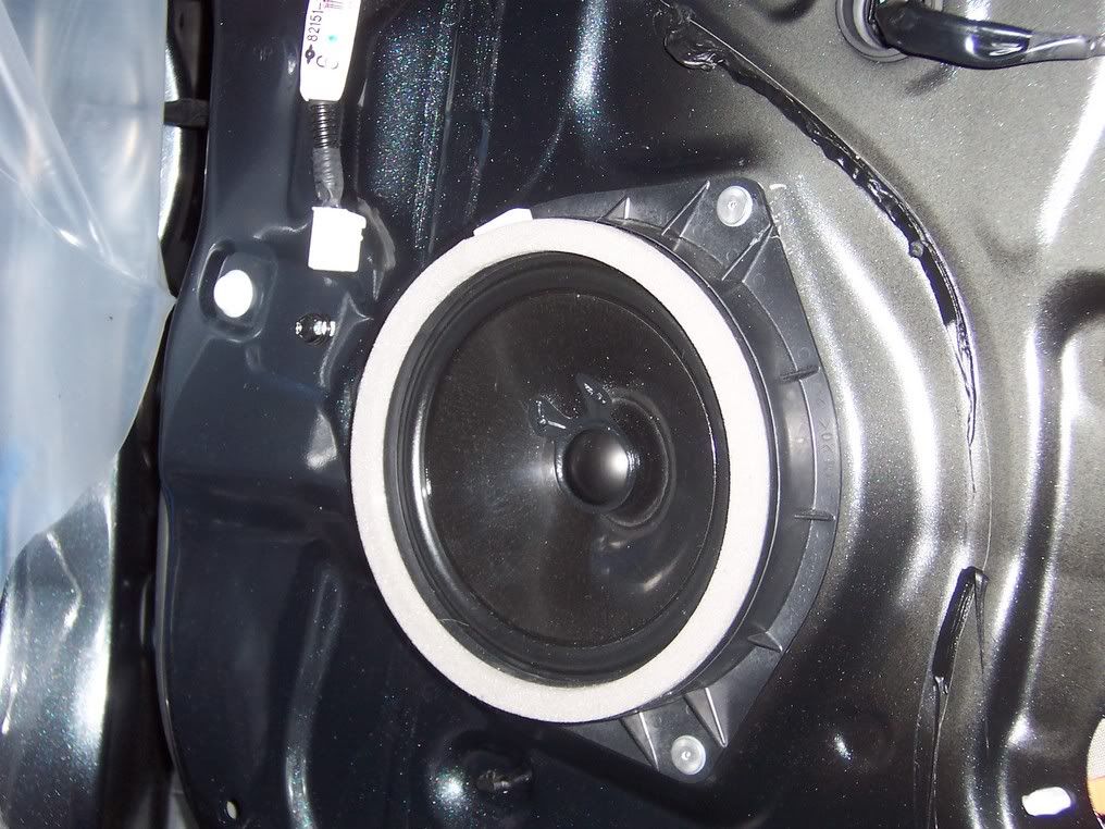

    alright so many people know i've stripped my Scion tC to do deadening and audio install...
    anyway we're at the point of taking the doors apart in more detail, but i have no idea how to take out my speakers.. there's some weird screws on them
    pic of speaker in door:
    close up of the screw things..... sorry its excessively blurry, might be better off just looking at the first picture
    If anyone has a good solution on how to take these out it would be great... thanks

    Those are not screws. They are rivets. My XB has the exact same setup. What you need to do is to drill the centers out with a small drill bit. The baffle and speaker is one piece and will not separate. You will need to make a new baffle. Trace the speaker onto a piece of mdf, cut it out and drill your holes in the exact location. You will need to cut the center out according to your driver size. Mount the new baffle to the door using new nuts, washers and bolts. I also used non hardening modeling clay between the door and the baffle, this made a much nicer baffle and also helped with the window clearance... do not tighten baffle completely as this will just squish the clay out.

    On 'Toyota' badged Yotas, they use philips head "tapping" screws (Part # 93568-55016) to fasten the speaker mounting bracket to the door. And they also allow you to remove the POS factory speaker from the bracket, again, via screws..

    i just cut the drivers out of the baffles on my celica and screwed the new ones one the stock baffles. works and sounds great
