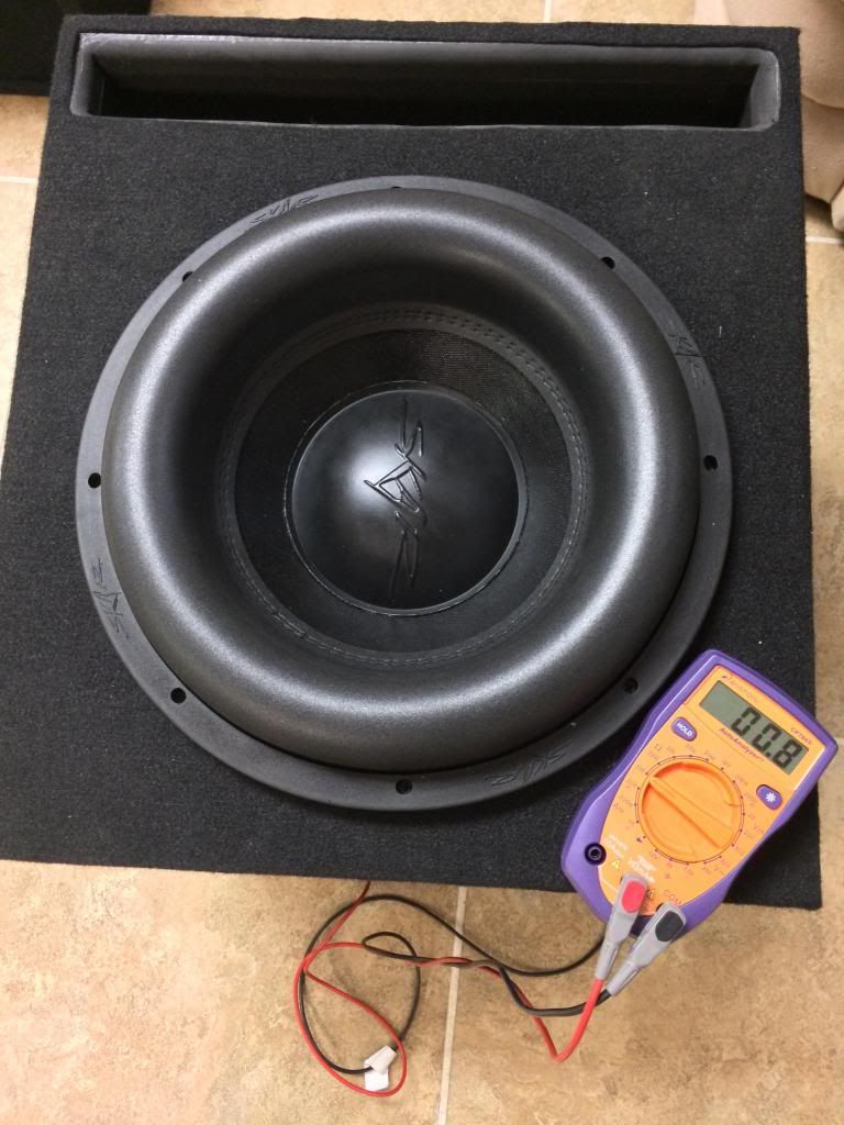

Test Load : (1) ZVX-12 D2 resting @ 0.8 Ohm

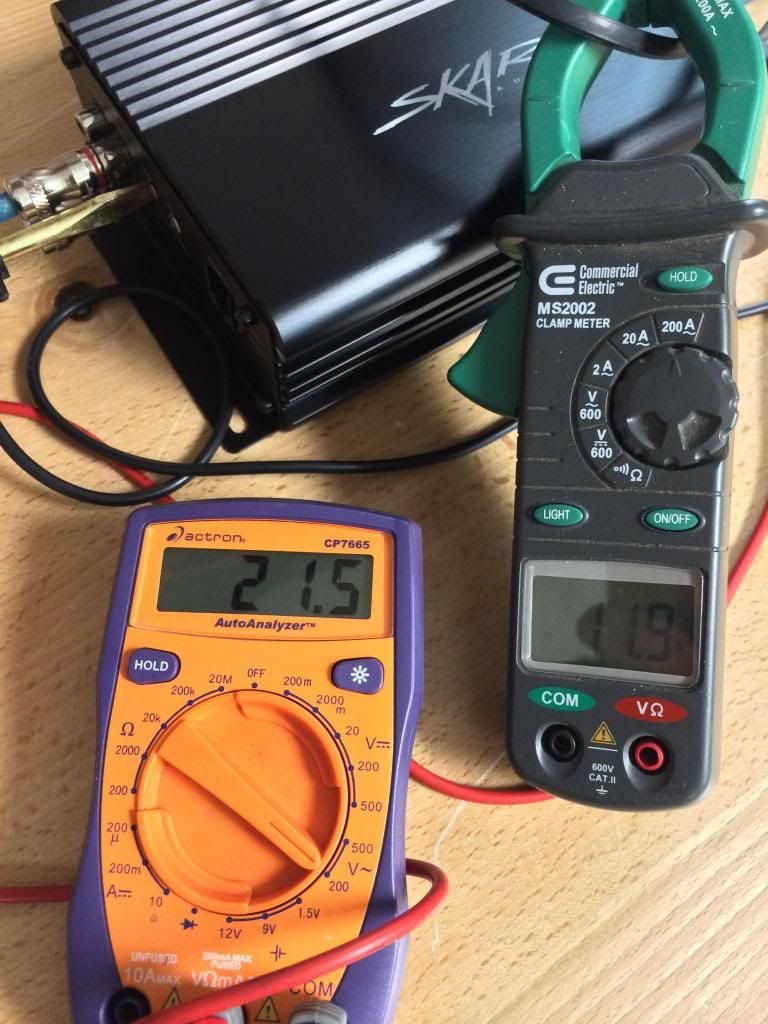

MSK-200.1D
POWER OUTPUT : 256 Watts (calculated)
AMP CURRENT : 11.9 A (measured)
AMP VOLTAGE : 21.5 V (measured)
ACTUAL IMPEDANCE : 1.81 ohms (calculated)
SUPPLY VOLTAGE : 13.17 V

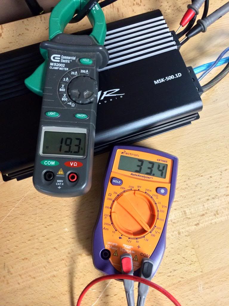

MSK-500.1D
POWER OUTPUT : 645 Watts (calculated)
AMP CURRENT : 19.3 A (measured)
AMP VOLTAGE : 33.4 V (measured)
ACTUAL IMPEDANCE : 1.73 ohms (calculated)
SUPPLY VOLTAGE : 12.88 V
