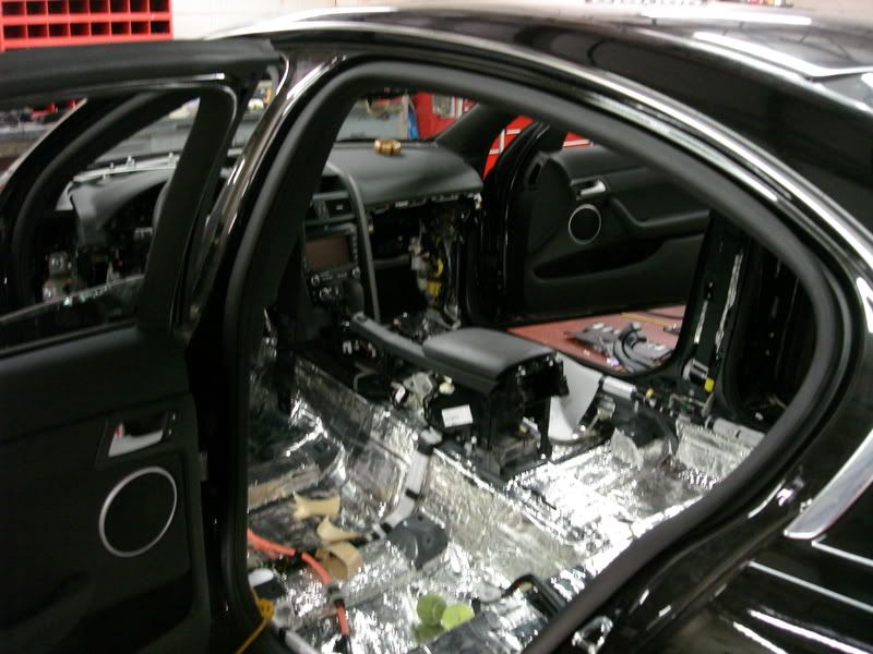

Interior Gutted:

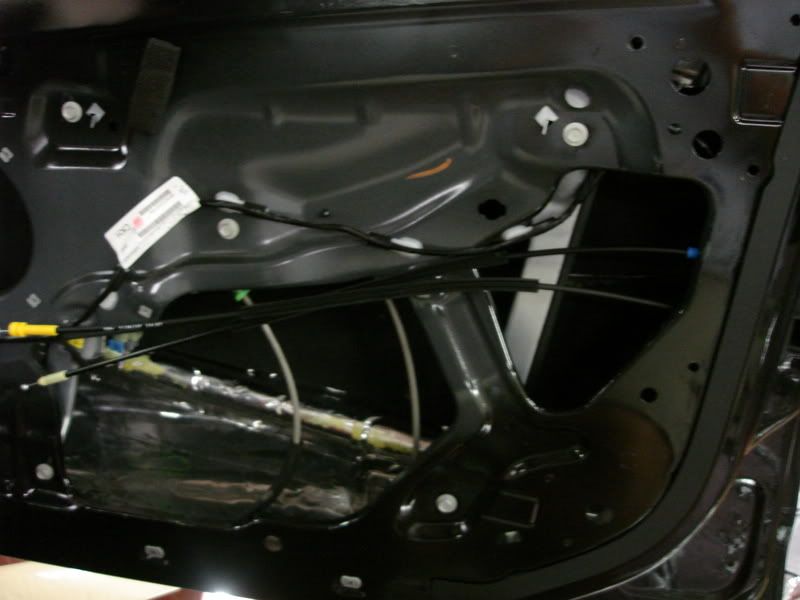

Outer door skin covered in 2 layers of Damplifier Pro:
Outer door skin covered in Overkill Pro foam:
Inner door skin with 165K2P mounted and covered in Second Skin Damplifier Pro:
