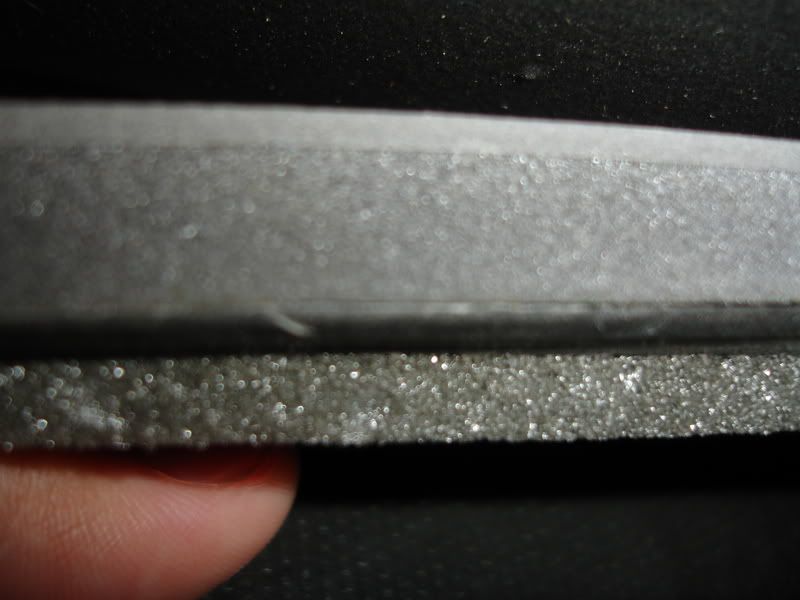

I was in search for a barrier of sorts which lead me to something containing a mass loaded layer with acoustical foam. The first choice was a lead layer with acoustical foam, similar to what Cascade offers but the price was too expensive for me. So two others were options for me Second Skin LuxuryLiner and Vertex Barrier Pad.
Anthony from Second Skin was gracious enough to send me a sample of LuxuryLiner and i got some Vertex Barrier Pad (VBP) from John (aka FoxPro5/B-Squad) as well. I got both products and compared them to construction, material used, and durability. I decided to go with the VBP due to superiority to material and construction IMO. The foam was more dense and thicker and the mass loaded vinyl layer just seemed more durable.

Here is a sample picture of a comparison between Second Skin LuxuryLiner and Vertex Barrier Pad (sorry for the blurry pics ):
Vertex on top, Second Skin on bottom
Vertex is vertical, Second Skin is horizontal
