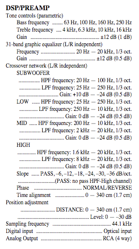

    It seems the deq p9 only has high/mid/woofer/sub outputs, how do i make this work for a front/rear/sub system? I want to be able to have front/rear fade and xover options. I am lost, i know i am in over my head, but i just want to make it work. i know the dex p9 has fr/rear/sub output, but how can i make that work, since the deq does to teh amp?

    you will not be able to because it seems they are set to a certain"width" only
    That may just be if you are using the Xovers. I think if you go into settings and play with the slopes you can set them to PASSive and get a fullrange signal for mid, midbass, sub channels.
