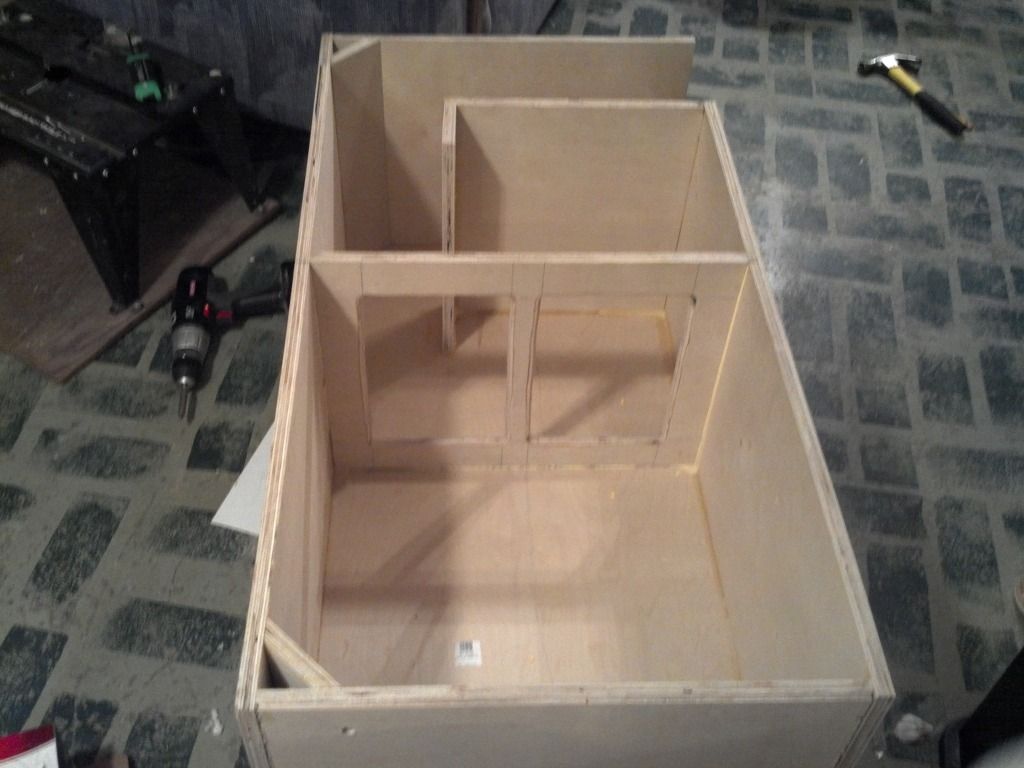

    Custom sub enclosure (built but waiting for sub):
    6ft^3 net
    35 hz
    108in^2 port
    Pics: (will get some shots of the truck soon)

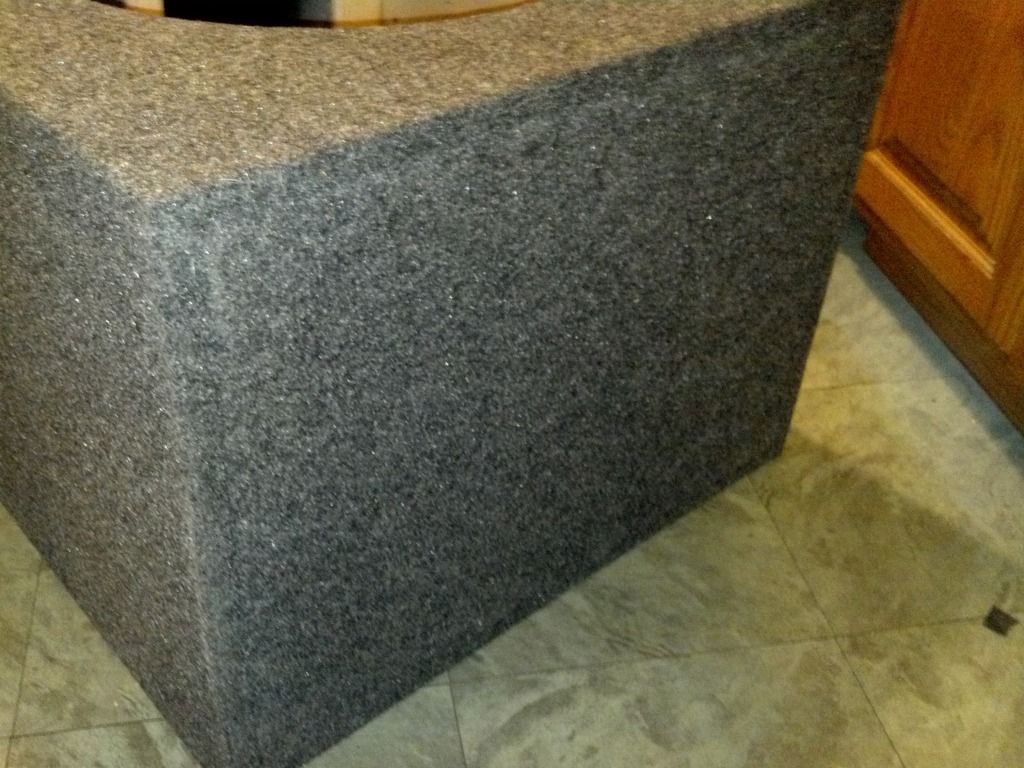

    First time using the rabbeted side panel method for carpeting:

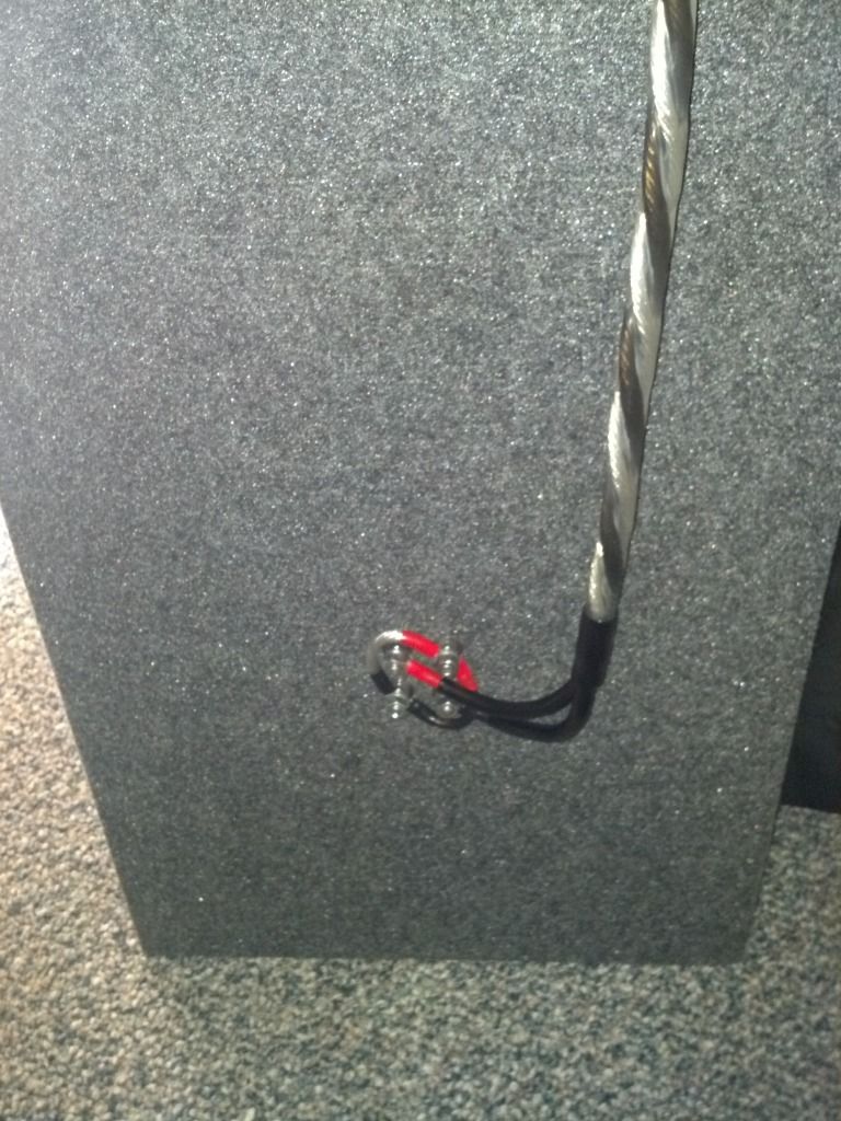

    Love knukonceptz' 8ga speaker cable!:

    note with that table saw that the extensions might not be the exact same size as the main table. that is a concern when the guide overlaps the seam, then the guide can lose true perpendicular and you can get binding at the blade. it can be a PITA to cut some dimensions. the best thing to do is laminate a later on the extensions so they are the same size as the main table (usually they are a bit smalller) so the guide can overlap the seam and remain true.

    The fence doesn't square the best even on the main part of the table. I measure both the front and back of the blade always just like I would on any table saw.
