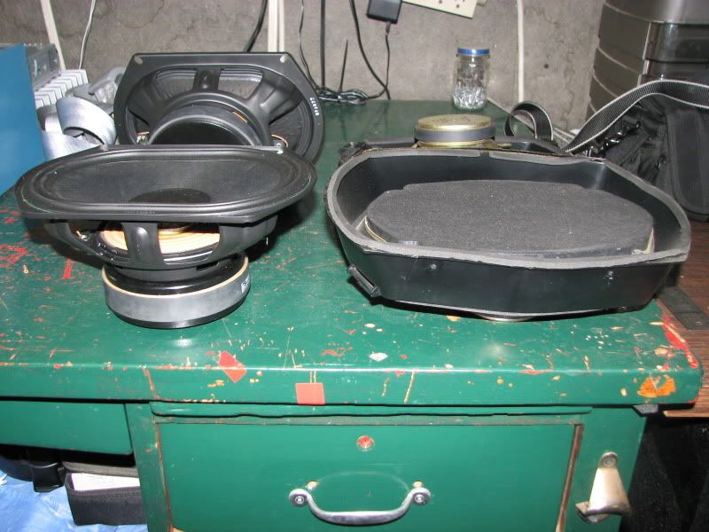

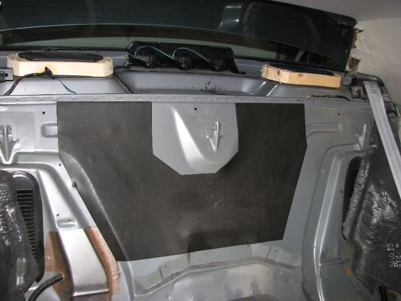

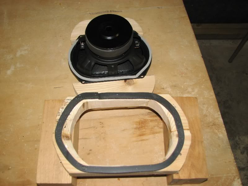

    Parts Express sells some 6x9 subs. i've installed the larger versions in place of Bose 6x9's in a 1990 DeVille.
    the build on that is located here:
    http://forum.sounddomain.com/ubbthre...190697&gonew=1
    cliffs: I laminated two 2x4's to get a thick enough baffle to clear the torsion bars in the trunk, and meet up with factory grill.
