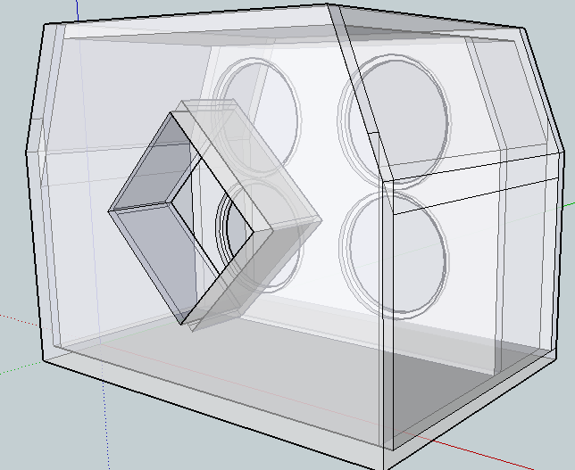

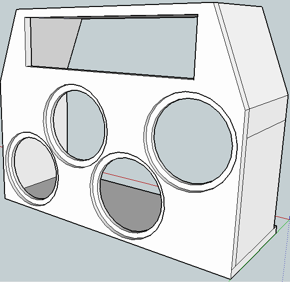

    okay so ive been working on a few designs i wanna do a wall behind my second row seats so a "C" pillar walls. not sure if i wanna go 4th order or just ported. what are your thoughts.
    info-
    subs: 4 sundown e15's
    vehicle: 2004 toyota sequoia
    location in vehicle : behind second row, c pilar
    box type: walled 4th order or ported wall
    amp: ta1.3000d

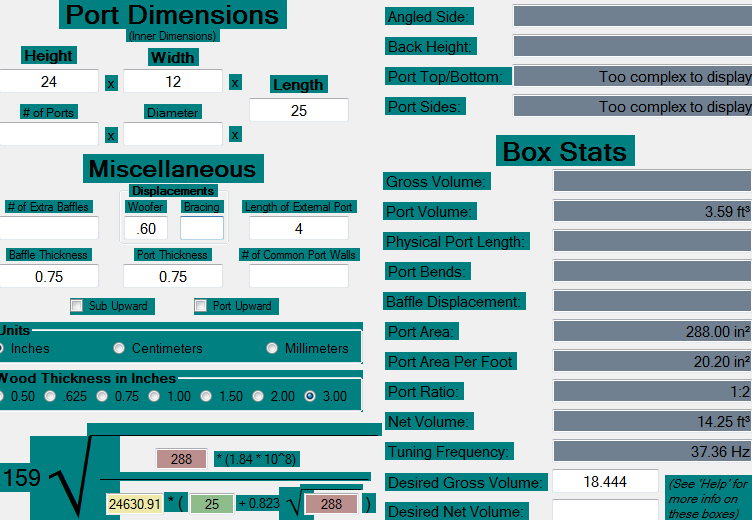

    I like option 3

    Quote Originally Posted by oldschoolboomer View Post
    I like option 3
    can i ask what it is that you like about the box and is there anything you would change

    Re: sundown e 15 wall help
    I like the tuning and net volume. If anything I would skin down the size of the port slightly but keep the tuning closer to the same
    you think i should tune more towards the 34hz range
