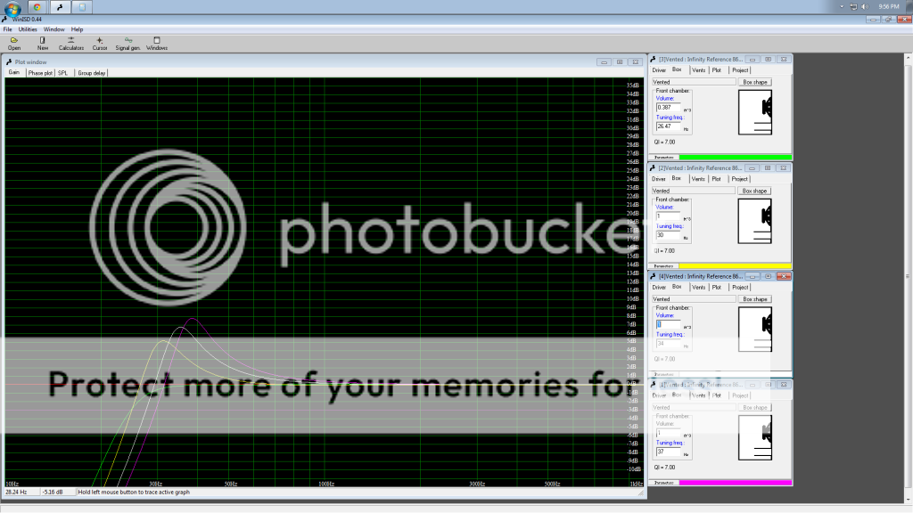

    I went ahead and loaded that driver into WinISD Beta (because I like unusual alignments) and here's what it reported:
    The green graph is WinISDs model, which is .387 cubes tuned to 26.47. But with a 3" vent, you're talking about ~66", lol.
    The yellow white and fuchsia are 1 cube each tuned at 30, 34 & 37 respectively. As you can see, the 37Hz box looks like a burp box. The 34Hz box is almost as peaky and the 30Hz is too but, it's also -3dB at ~25Hz, which is the same -3dB point that WinISD came up with so basically, that's about as low a reach as you're gonna get with those drivers. Group delay for all of the one cube models is ~40ms but WinISD's model isn't a whole lot lower, at around 30.

    Interesting, so that cube at 30hz is looking like a solid route to go. It is a tad peaky but definitely better than not being able to port it. Thanks for taking the time to run that through for me, now I have a direction to head in with this design. Bassboxpro was showing a similar group delay spike, hopefully that won't sound too sloppy. Thanks for your help sir.

    My pleasure. And look... you could get rid of that peak by making the box .387 cubes tuned to 26 Hz.
