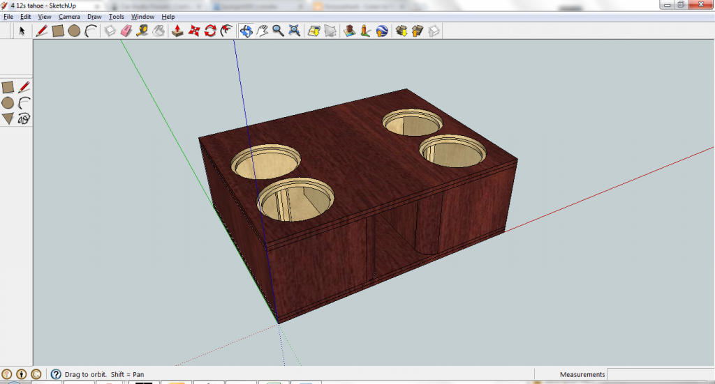

    I am planning a sub box for 4 12's to go in my 2006 Cadillac CTS.
    I have measured the trunk and have the room for this box but need opinions on the sound quality of the box and some sub recommendations.
    sketchup.google.com/3dwarehouse/details?mid=fd047eb982aaf475ee81fbdf24e2fa89

    terrible configuration for that vehicle... also looks like you have to little port area.
    ---------- Post added at 10:28 PM ---------- Previous post was at 10:28 PM ----------
    if you must have four and have to fire upwards(even though its a bad idea) try something like this.

    Quote Originally Posted by RangerDanger View Post
    Second that.
