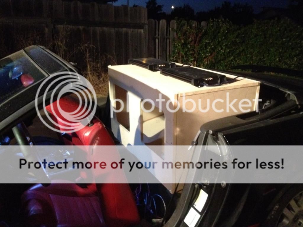

    After further research on the L7's, I realize there's no way I'm every going to get them to reach their full potential in the trunk.
    They're gonna want around 12 cubes net, so I'm going to abandon that idea, and focus my efforts on a SQ focused system.
    Here's some pics for fun:
    Transporting my mdf
    The box half way in
    So to conclude, could you guys lead me to where I could learn about and design a SQ setup?
    I have all of my equipment, as well as 4 boxes of speakers and amps unopened from kicker I've never installed.
    My hope is that I can use the value of them to purchase my SQ equipment?
