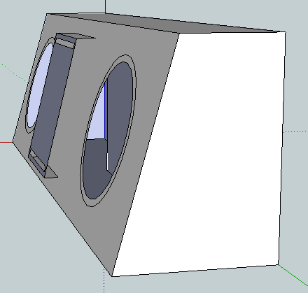

    okay so i designed this box on google sketchup and just wanted to know what you guys thing below is the measurements in the torres box tunning program
    Recommended Enclosure Specifications
    Minimum Sealed Box Volume 0.50 cubic feet
    Maximum Sealed Box Volume 0.75 cubic feet
    Minimum Ported Box Volume 1.40 cubic feet
    Maximum Ported Box Volume 1.40 cubic feet
    Vehicle : 1991 toyota pickup
    Location in the vehicle: behind seats
    Space available (Length x Width x Height):45"x7"x5"x14"
    Subwoofer make and model: rockford fosgate rs2d2 shalow mount
    Subwoofer Size: 10"
    Number of Subwoofers: 2
    Type of Port (Kerfed, Slot, Aero, etc.): dont think its possible with space
    What type of music do you like?: mostly rap
    Is your goal SPL or Everyday Music?: more bass the better
    Tuning Freq (Hz): not sure if you can tune a ported box
    Volume : 1.41 cubes
    Questions: is this setup gonna work and sound good for what i want

    I used to have two 10's sealed, with 350w in my 88 toyota. I sealed/attached the box directly into the truck (the back wall of my truck, worked as the back of the box), which gave me more box volume. My truck smelled for about two weeks, but it was worth it. Many people thought I was running twelves or larger.

    Forgot to add, that my box design was almost identical to yours. I just used the back truck wall, as the back of the box.

    that works but need to use a sound deadner on the wall, metal likes to resonate quite badly
