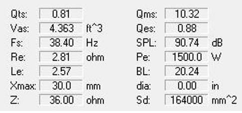

    Both are nice, we used 16 @ 36 for a 154.7 Headrest/Termlab @ 38Hz Jeep Grand Cherokee. They are boomy in that little airspace though, the DP 21 has an pretty high Qts making optimum response require alot of enclosure volume. This ought to stear ya in the right direction!
    TSP's:
