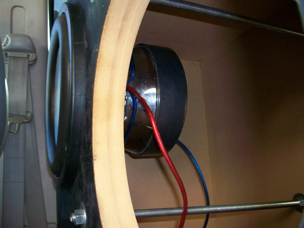

    I like using threaded rod, doesn't take up any space and is easy to do. Bolts on the outside and inside of box so 4 total for each rod. Tighten the bolts down real good and they sandwich the wood inbetween
    best pics I have but should give you an idea

    BHs that helps a ton but how did you get the bolt on the inside? and by 4 each that means theres a bolt showing on the front and back of the box?? that was the main concern was on how exactly to bolt the rods down.

    Yeah there's a nut on the inside and outside of each face the rod is going through. Think about it if there's only a nut on the outside the box would still be able to flex in, the nut on the inside prevents that.
    Drill the hole and put the rod in. the nuts on the inside will need to be put on next...it takes a while because you have to spin the nut to bring it to the face of the box you put the rod through
    idk how to explain it but once you drill the holes and put the rod in you'll figure it out
    that one you can clearly see the one on the inside
