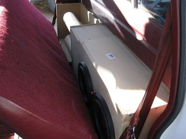

    Re: Help with ported truck box???
    Subs forward on driver's side, port out passenger side seems to work best in my truck. These boxes don't have the slant face on them, but will give you an idea of what I did...
