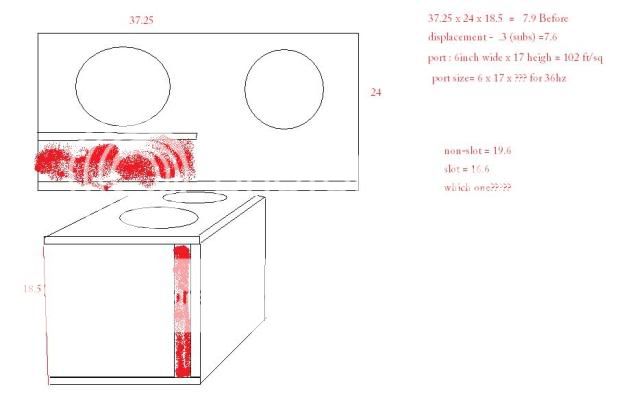

    Two 15inch sd2.5 box need go signal!
    this is what i want to do. box size 37.25 lenght x 24 deep x 18.5 heigh for 7.9 internal before displacement. Subs take .3ft/cu. Port area 102ft/sq
    port dimension are 6wide x 17 height. Can i just use one mdf sheet for the wall? i'll be sanding the corner to help with port noise. port on the side like pictured.
    I need to port lenght dimension for my box. I want to tune the box aroudn 35-36hz
    Calculator tell me : non-slot : 19.6 slot 16.6. What do i need to use??? so confused
    I'll start the build once i'll get a go signal

    Did you subtract for port volume? I'd do 16^2 of port per cube and make the port 20" long for a 36Hz tune...

    no the port volume ain't sustract cause i don't even know how long it got the be
    I'm doing around 14 ft/sq per cube so i can still have some airspace, you know

    too small for 2 15's IMO. I did 4 15" HDC's in 12cubes last year and it was less then ideal, and you're going to be around 6.5^3 at best after port displacement...

    DJ says it's ok. Those aren't hdc model and if i remember well, the sd2.5s don't need as much airspace. that'll be 6.5 net / 2 for around 3.25 per sub. It ain't bad you know, in a such little car.
    Dj says the port wall need to be 20inch long. I'll fallow his instruction, he must be the one who knows these subs the best
