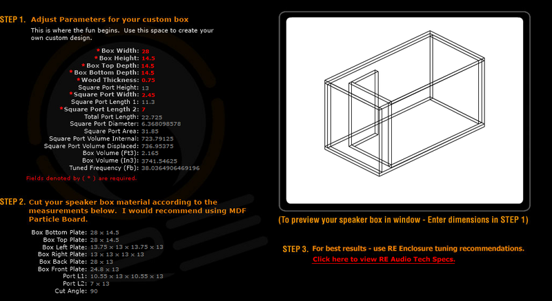

    Hows this box look for my SDC2.5?
    DJ recommended around 2 cubes at 38, and I whipped this up.
    This is my first box, and I've head mixed things about RE's calculator in the past, so I was looking for some other opinions before I pulled the trigger on it.

    What size sub?

    Sorry. A single 12.

    Thats bout right for the size. To be honest, I dont trust REs calculator also... IDK why...
