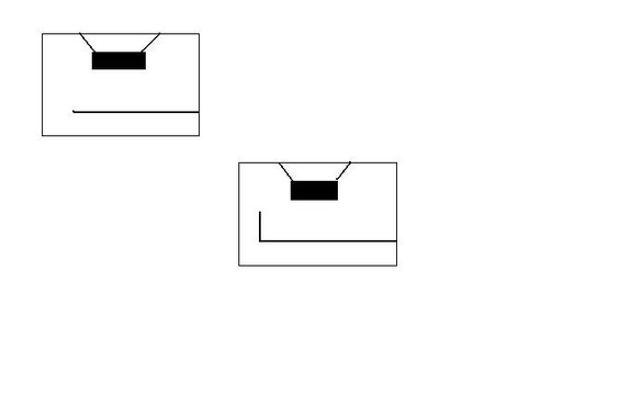

    How would a CRX style box work with a single sub?
    If I am correct the CRX style is sub up and port across the bottom?
    If I were to do something like that, only instead of having the port go all the way across the bottom, I'd do it in the center, and have the sub directly over top of it... would that cause any loading issues/sound like ****?
    I could then do sub up/port firing towards my ski-hole and see how that would sound.
    Hopefully that is understandable...
    EDIT: here's a ****** paint pic of what I mean. The black area would be the port, with the black "line" on top being the sub.
    Another question... if this box style will work, would it be better to have the port stop before the back wall, or use part of the wall to contunue the port in an "L" shape?
    Like so: ("looking" sideways at the box.)
