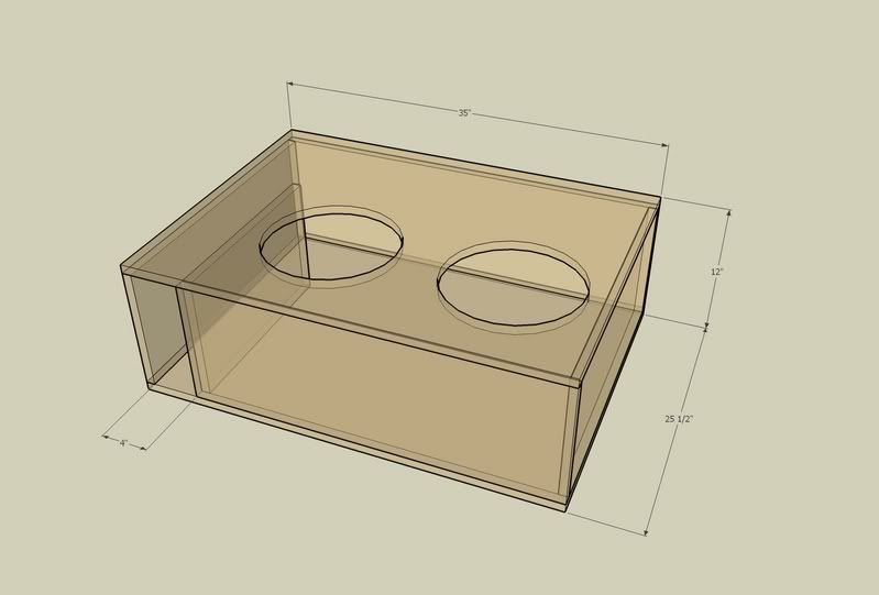

    can someone design me a box? paypal ready
    Need a simple ported box for 2 12" type r's. My max demensions are
    Width-35.5
    Depth-25.5
    Height-12.5
    It needs to be an all out daily driver so probably tuned to 35hz. I would like the subs and port facing up. Paypal ready lmk!!oh it's going in a Scion TC

    Here are 2 to suite your needs, just a FYI,
    you can do alot better, as to spec, with round port on the side of the box.
    4.1 @ 35hz 44 sq/in
    4.5 cu/ft @35hz 25 sq/in

    awesome you guys are great
