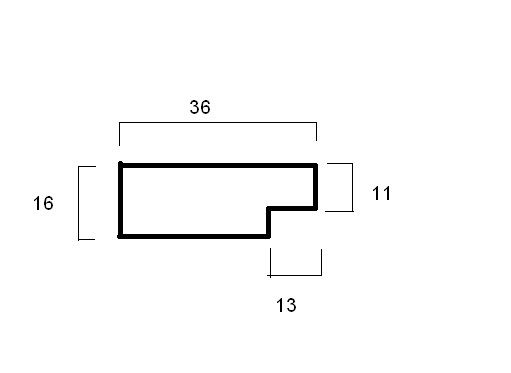

    Because of the shape of my trunk I would haveto build a box that looks something like this
    in order to get the air space I need, I've never built an odd shaped box so I don't know what type of port to go with. Any suggestion's? Also this a side shot and the width is 40in.

    If it helps I want it tuned to about 32hz

    Is the "hump" in the back or front of the enclosure? Looks like you have somewhere around 8.9 cubes.
    You could easily make a slot port of areo port design out of that. Let me know where the hump is.

    It's in the rear of the enclosure.

    I finished another guys plans lastnight got back to start on yours and my crappy laptop crashed again. I will do my best to get you a few designs tonight.
