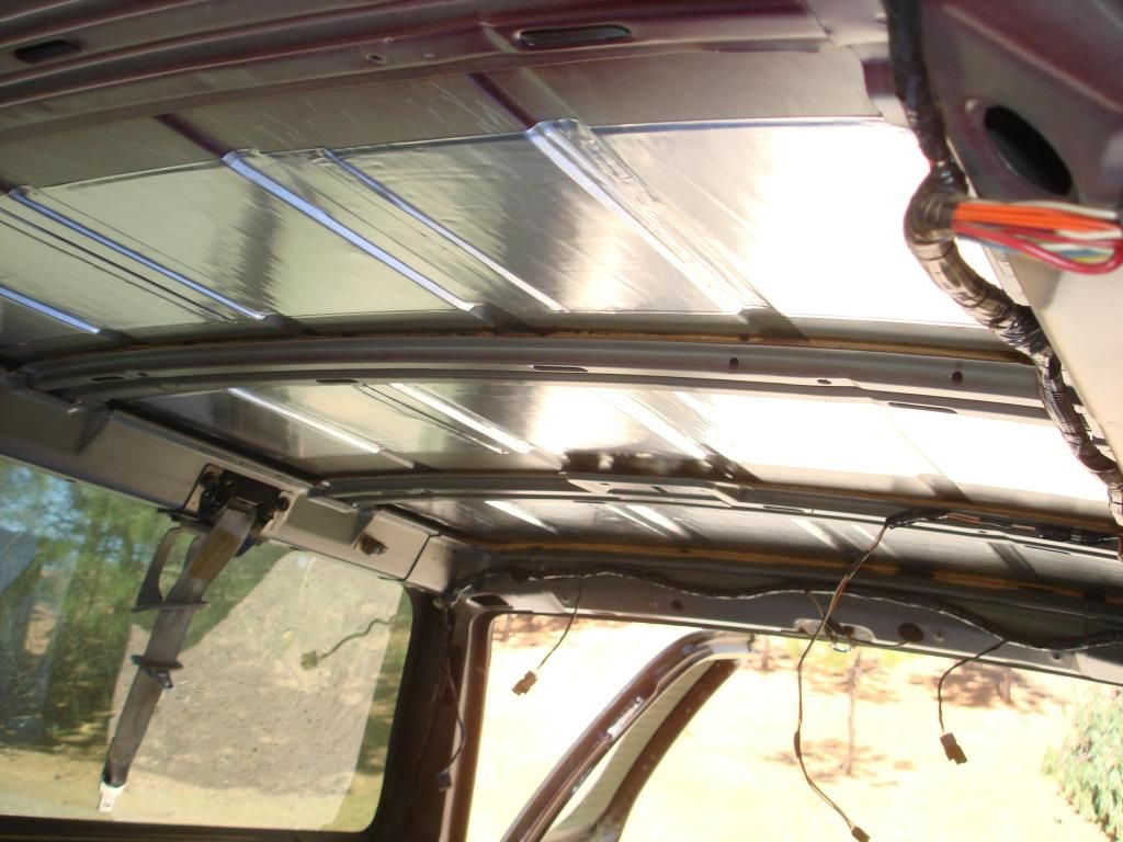

I just finished installing 20 sheets of Alpha Damp in the Suburban's ceiling.
I'm just one tile short on finishing the ceiling as you'll see in the pics.
I have a new found respect for those of you that do this for a living.
Rolling cld tiles on the floor is one thing, but rolling them down in the ceiling is quite another.
The results from the tapping test were nothing short of amazing considering the roof line is over 15' long and the sheet metal is thinner than the floor.
I will post the demonstration video once it finishes uploading to youtube.
Next stage will be installing Alpha Damp in all six doors and the two inner quarter panels and then it's onto MLV installation.
