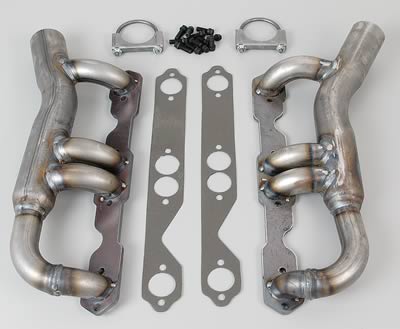

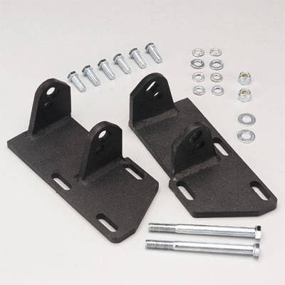

    There's a kit for it, motor mounts, new oil pan, headers...uhhh think that was it, check out summit
    probably need some of this stuff
    THIS MIGHT BE A GOOD IDEA
    all here:
    http://store.summitracing.com/egnsea...115+4294840140
